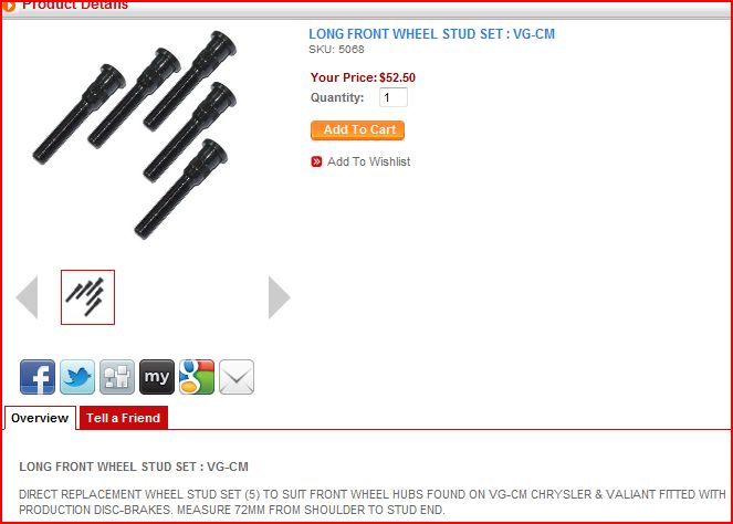

Before I have to remove hub and disc and knock one stud out. Anyone know the exact measurements of the Aussie front wheel studs?
7/16 unf.... But what length?
Any different knurl types (length of knurl on shank)?
VGVIP
Loooonnng
72mm
And look to pass through the disk then the knurl seats in the hub.
Any thoughts on reusing studs that have been driven out?
http://www.pentastarparts.com.au/sunsho ... ail&p=5068

Ah, that makes sense now. re the 72mm.Dave999 wrote:differing lengths for alloy ROH or GKN Sankey benson option W35 wheels...jelly bean mags. OR plain steels i think
I am left wondering about the spline (knurl - poor choice of word earlier) and shank length and diameter now.
You can see the first one has the spline placed to pass through the disk but seat in the hub (disk is mounted behind the hub). The shank seems to be larger diameter between the spline and head.
The second one has the spline closer to the head of the stud so it seats inside the disk. The rest of the shank would have to be correct diameter to seat inside the hub and stop movement.
Maybe the disk has a larger diameter hole than the hub.
Guess I wont know for sure until I remove mine.
Job for Saturday - no rain for a change!

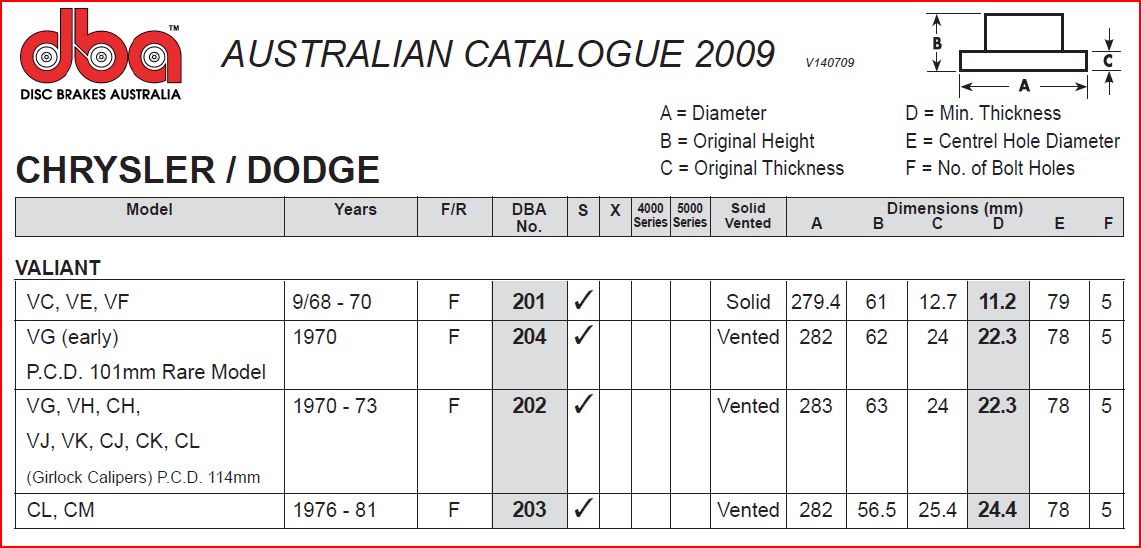

I would also be interested in sizing up the hub/disk against mine as it may be an option in the distant future to go to the larger pcd by a hub swap and re-drill the disc.
I suspect that the only difference between my new discs and yours will be where the holes are drilled. Reading below chart there may have been a small amount of extra machining. 1mm
Have an idea that if there is a set of hubs at a place a couple of hours to the north of here for a reasonable price I may get them to put in the shed.
Extract from the DBA catalogue attached.
Note the minor difference between DBA 202 & DBA 204

New rotors fitted on Saturday between mowing grass and assembling a swing.
Good to finally be able to spend a bit of time working outside without all the liquid sunshine we have been having!
Thanks Terry for the loan of your parts, will return them all including the studs, did not damage any of yours or mine.
Need to check for runout of the mounted rotors then rebuild my hydraulics. Waiting on parts and time.
After the other bleed screw also broke (both calipers) I am expecting to have trouble undoing the flexi brake lines from the hard line to replace. So have started a process of soaking the joints in WD40 in the hope that it helps.
A few observations:
- rotors easily removed from hub.
- My new rotors, made by RDA (Rotors and Drums Australia). Measured to be the same dimensions as the DBA specs above.
- Old rotors (both my VG and Terry's VH?) have a smaller diameter of roughly 275mm. Original factory fitted rotors I suspect. Maybe the later models VJ onward had larger rotors than the ones I have seen.
The reason I think this is because the outside pad on my Girlock calipers actually passed the outside diameter of my original rotors but will not on my new ones. Girlock calipers were fitted to VJ I think? Were VG & VH got the same Girling caliper with the slider pins.
- The studs (both Terry's and mine) are shorter versions of the first picture above. The shank has a larger diameter closer to the head then is reduced for the second half of the shank where the spline is located.
The rotors have a larger diameter hole than the hub.
- My new rotors could be re drilled for the larger pcd if need be in future. Meaning it would only require re drilling the rotors and change of or re drill hubs to go to the larger pcd on the front.
