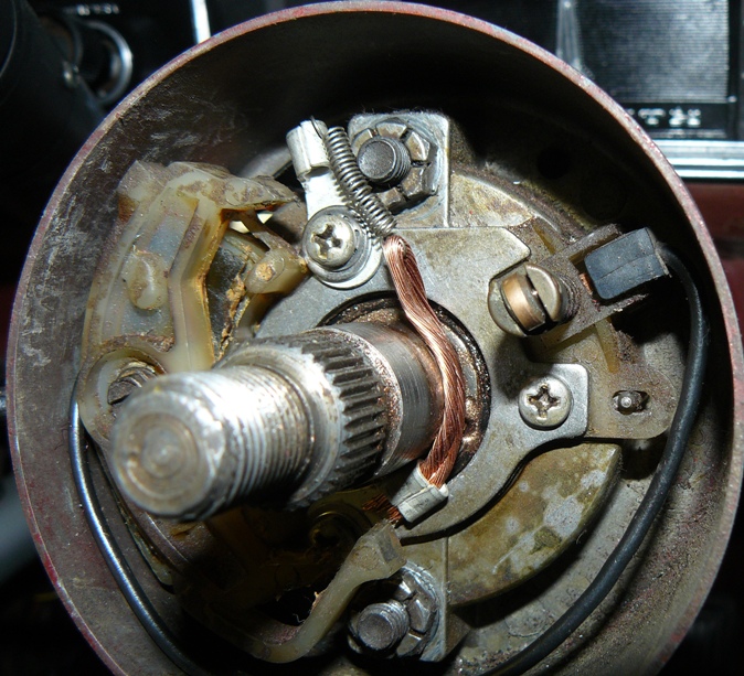

How does the switch connect to earth?
It seems to go to the steering column shaft but this rides in bearings and is isolated :scratch:
I'm about to make a copper brush to ride against the shaft to provide a connection but if anyone knows how it's supposed to work?

Have you got a horn relay on yours Paul? Mine is behind the glove box.
http://www.moparmusclemagazine.com/tech ... ewall.html

Thanks Ade, sorted now.
One of my better bodges i think... :D
