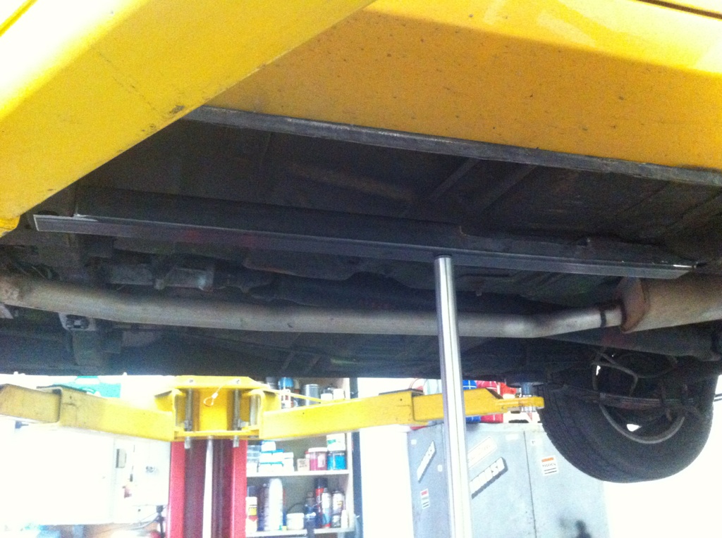

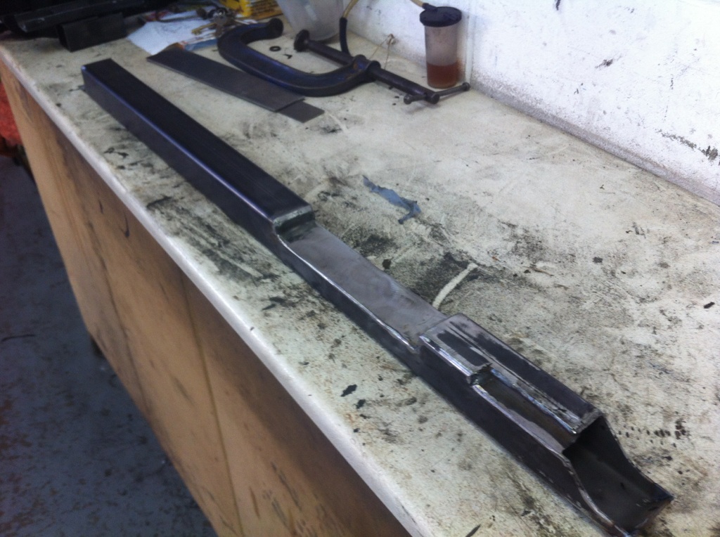

So Anton build some up and fully seam welded any section that needed to be cut out to get them round the floor and the RHD hand brake conduits fuel line etc. Remeber its a LHD floor pan with all the drivers side stuff tansfered to the RHS so you have fuel line and handbrake on the same side
the rails were welded in
they butt up to the cross members but also go over the torque box/chassis cross member for a strong join much like the hotchkiss set up does.
does it work
oh yes the combo of both changes is great
rear end feels solid and secure, it handles the bumps and changes of camber without the teeth jaring thumps of the previous set up
my shocks actually have a job to do now
i no longer feel like the steering wheel is just a device used to wag the tail end of the car about in a random manner.
all latteral movemnt of axle is gone or at least greatly reduced going by seat of pants feel
and the rear end follows the front immediately, if the reverse of scuttle shake (rear end shimmy?) exists its gone, there is less of the rear end slowly side stepping and wheel hopping over pumps and ripples as you blat round long slip road type corners
I like
Job done.
Anton kept me up to date on progress, any issues were discussed and he also sent a load of of photos
some pics
note the section out of the rail
i didn't want them welded into the floor, personal choice, car needs to stay reasonably standard, or at least within spec of orginal race team cars. its one of 1300 made so it seems wrong to mess it about too much.
However the rail would vibrate aginst the floor without the cut out....obviously a cut out makes the rail thinner which is why the cut out has been fully welded. should be stronger than the profiled 3 sided off the shelf things.

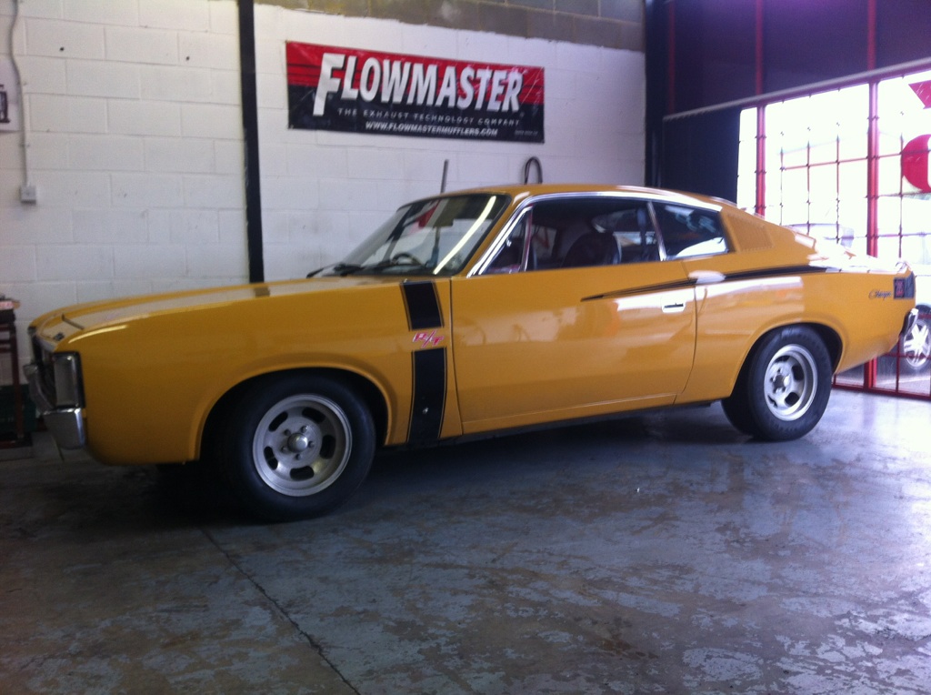

stance is how i wanted it, slight scope for settling
front end build will see the front come up about 1/2 and inch and bigger wheels
No more arse dragging, and eventually a slight nose down buisness like look
it looks more like the factory fresh chargers in pictures of old
Cheers Anton i'll be back for an exhaust
