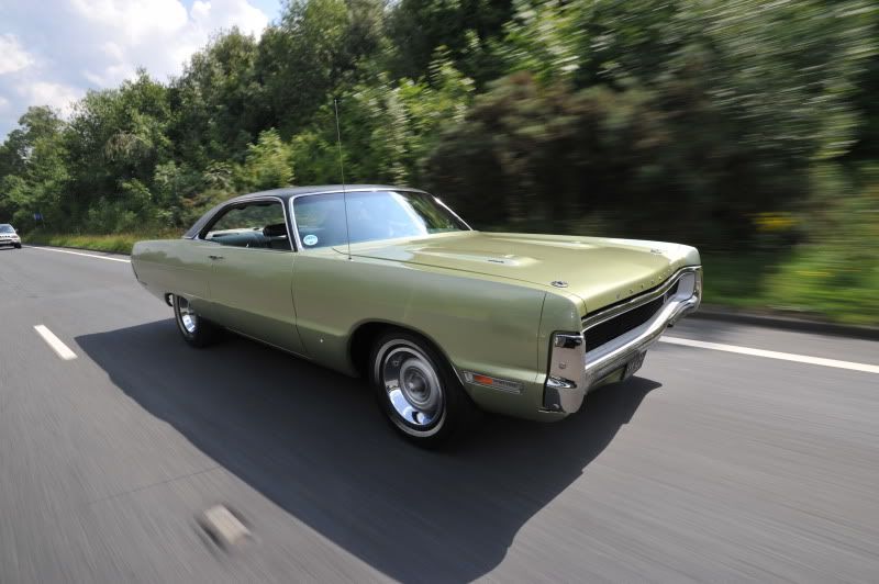

I recently went out for a Drive on a dry,yes really,day and whilst waiting at some Traffic Lights the Wind caught a Roadworks Sign and sent it down the rear quarter of my Car.The Council have paid out for repairs but I am not sure of the colour code,is it Light/Lime Green Metallic ? I have noticed other Cars in this Colour and would greatly appreciate any help.
URL=http://s116.photobucket.com/user/caddyd ... 2.jpg.html]Image[/URL]
The paint code is on the fender tag if it is the original paint??

sorry to read of your misfortune, your car looks gorgeous
that looks like F4 Light Green, my car was this colour originally
although for your model it’s listed as F4 Lime Green …
http://paintref.com/cgi-bin/colorcodedi ... =3&rows=50
the paint manufacturer codes appear to be the same
check your fender tag for sure, look for F4 or FF4, on mine the paint code is second row up on the left
apologies if any of this info is misleading due to differences between the models
Posts: 13003
Sorry to hear that Stewart, considering the age of the car, together with sun bleaching and weathering, I would have the bodyshop match the colour either with a swatch system or portable spectro because it's bound to be way off the original! ;)

That is one of my favourite Mopars in the club ..... stunning
=P~
Hope you get it sorted

Thanks for the replies,couldn't see the info on the Tags that were there unfortunately.My Bodyman mixed up some F4 Green and he tells me it's very close.He is a really careful Chap so I am confident of a good Job.

Wow. That car is gorgeous.
Good luck with repair. :thumbright:
