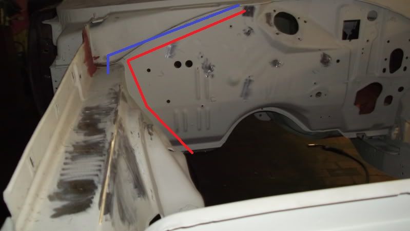

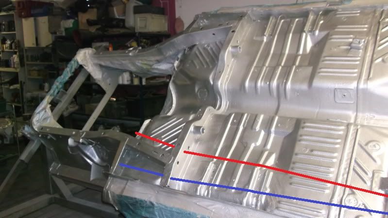

Running fuel lines how do you run yours !!!!!!!
- autofetish
- Posts: 5599
The main fuel line feed and return.
Do you go blue and outside of chassis leg
^^^risk of damage from something kicked up by front wheel in arch^^^
Do you go red and inside of chassis leg
^^^ risk of heat from manifold its a tight space ^^^
Seen both ways done on some lovely cars at the nats
pros and cons thoughts ??????????

Adrian Worman wrote:Yep mainly Blue route, use the drop on the inner sill panel to shroud and attach the hose clips, braided hose can get peppered by all sorts of debris from the road and be okay so don't fret it too much
Im doing everything in 5/8 20swg stainless hard line with a bit of flex at engine
Would hard line be up to it in wheel well ???

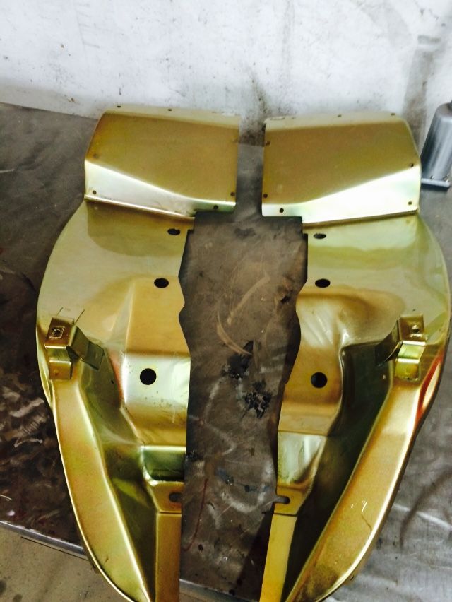

There is inner wheel arch panel with rubber trim that should go on the inner wheel arch to protect the door hinges and fire wall from debris
