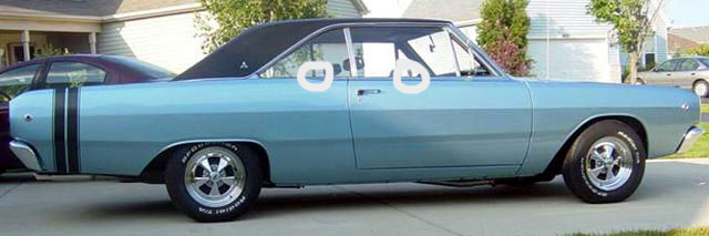

Hi all, what is the best way to remove the side glass lower chrome strips. The area circled. Not my car, web image.Thanks
Posts: 14522
If you mean the strip that runs across the top of the door, if it's the same as my '71 was then there's a wire clip on the trim that just pokes into a hole in the door. you want something flat and wide like a putty knife to slide under it and carefully lever it off without bending it, it will probably come up a 1/4" or so before the clip releases.
