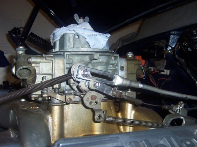

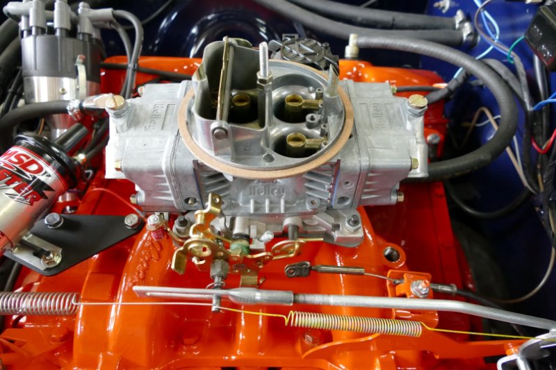

we've just got the new engine fitted to the Sport Satellite and we've just found that the original throttle cable is a tad short now it's got too reach the carb on the taller Edelbrock Performer RPM inlet. It was fine with the old (non-RPM) Performer, but the taller RPM is obviously causing the problem.
I was wondering if there's a longer cable available, but as I haven't seen any longer versions for sale (only needs to be about 1" longer) I'm wondering if the usual fix is to just make up an extension piece to bridge the gap?
Thanks in advance [-o<

I'd make a link to fill the gap. Or http://www.manciniracing.com/hemthrotcab.html

Thanks Steve, yes I looked on Mancini's site but as the car's 50-odd miles away and I don't know how long our cable is, I don't know what length we'd need.
As for a link to fill the gap, I thought we had that before, and Stu's just emailed this pic to show what we had, so we'll prob do this and then consider whether to get a new cable made...

Start off with a Holley 20-7 lever extension for Mopars, that mounts the stud in the correct place and you can work from that. I normally use the stock cable and cut and weld the cable bracket to get the clamp in the right place, you only need a longer cable with a much taller manifold.
