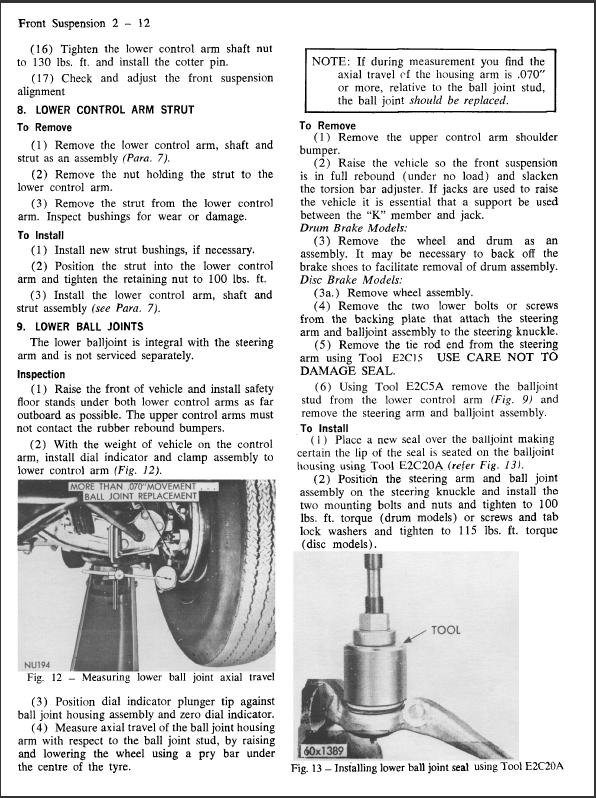

Re: upper ball joints
replacing an upper ball joint is a PIG and each arm should have it done only once or twice.
if you can avoid taking them out, I would they are rarely worn out.......
the pressed arms have no thread in them. ball joints cut a new thread, the more replacements that you do the more the arms ware out.
getting them in properly straight is hard work... if they go in twisted they splay the hole and ruin the arm....
its the lowers that take the hammering anyway....
and they are not worn out until the play is massive by modern standards they are a metal on metal none pull through design. replacing a decent metal/metal one with a plastic cupped none serviceable item is potentially a false economy especially if you ruin an perfectly good A arm in the process....
best bet is new moog or old stock mopar lowers
at the top clean fully, and get new balljoint seals (NOT boots/balloons with metal key ring style retainers) you want the press on plastic rimmed original style seals for the uppers
these look ok https://www.rosevillemoparts.com/produc ... 72-b-body/
and a tube of Mopar Multi Mileage Lubricant long stand barium grease.... part number 04897841AA
and a decent grease gun.... top joints will be good as new and need reapplication in 5000 miles
- Balljoint.JPG (141.6 KiB) Viewed 2290 times

thanks dave,for the information,i have been greasing the ball joints up for years,but one of the upper joints has got a bit of play in it,so it needs to be changed,probably best to do them all,had a look on summit racing,and they list the ball joint socket as a ,1-59/64 in.sxt,10213.sunex ball joint socket.have sent them a email,to make sure this is the right one.the upper joints I have are,moog k,772,dont no if they will get back to me?probaly best if I can find out before I order one,as I am going to get a few other parts as well,will see if I can make contact with anton,or if I can think of any one else
