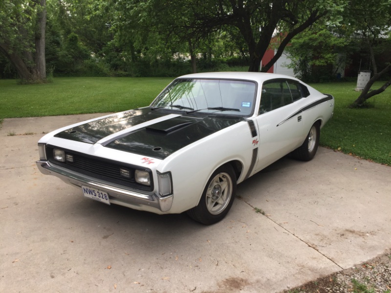

Nothing original about this car. Dressed up as a VH R/T. It’s actually a base model 215 VJ. Got a 770 drivetrain and odd combo of a CL interior.
Still, I found it locally in Michigan. Other than my old car (that you all know) I know of only 1 other in Michigan, so I currently own 2/3 of the market here :help:

Looks good, I like it :thumbright:

super i like it
must have been a PITA extracting grill lights driving lights and grill surround from someone in Oz? the cost these days is rediculous

Pretty car! Nothing wrong with a VJ dressed up to like a VH R/T.
