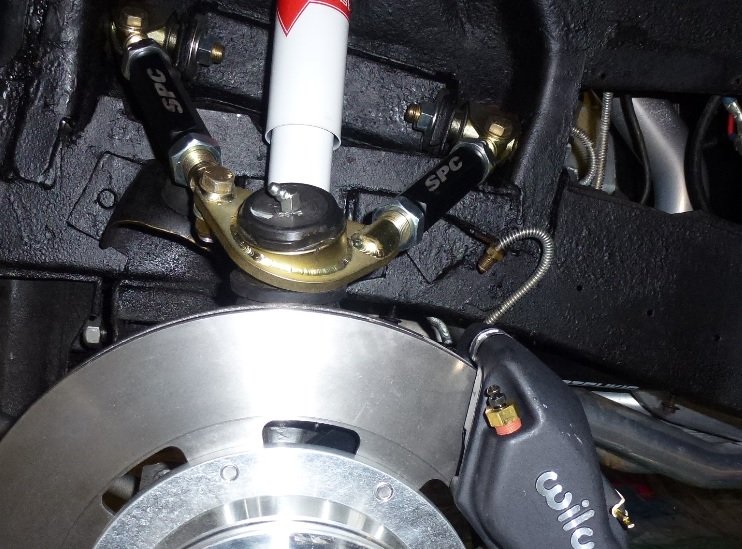

I dont know if he is still doing it but Roger from (ex?) Monkfish did mine - really knows his stuff.
The problem you will have is that they were never designed to give enough something-or-other (castor ? Camber ? Dont remember which). The adjustment is all carried out on some egg shaped cams on the bolts - which apparently dont move enough.
I ended up doing tubular UCAs which adjust every which way - depending how serious you are it might be worth looking into ?
Anyway. Find Roger !

you can lie feet going back under the car head sticking out near the front pumper looking at the thread and adjust the track rods with each hand.
you need to achieve a situation where you get the black dot 4-5 mm past the pin when the pin is at the front of the wheel
and ideally you achieve this by adjusting both track rods equally otherwise you introduce a slight pull left or right.
this gives you a smidge of toe in when standing still and hopefully that amounts to 0 toe in when the rolling resistance of the wheels causes everything to move slightly when in motion
have a cup of tea
do up the track rod clamps and take a gentle drive
No hands and it should not need correcting
steering should self centre from a corner
all good
go for a 10 minute drive
come back and check tyres for fresh peel on the very edges of the tread on the shoulders if none ... no scrubbing.
you are now in a position to say That'll do or to drive safely to the alignment place to get you handiwork checked
hopefully the chap does spot some tweaks he needs to make. if he doesn't i'd suggest you find a new alignment place
you are looking for a 1/16 to 1/8 inch toe in 1/8" is 3.175 mm
2.5* castor angle or more if you want it heavier
anything from 0-1* camber depending on how you like it in the corners if you are circuit racing on track you might want way more camber. 2 small hardened washers between ball joint and spindle mount can get you huge camber. but you don't need that unless competing, mancini racing do some special thicknesses
Its a bodge but it will get you going in a none tyre scrubbing way.
