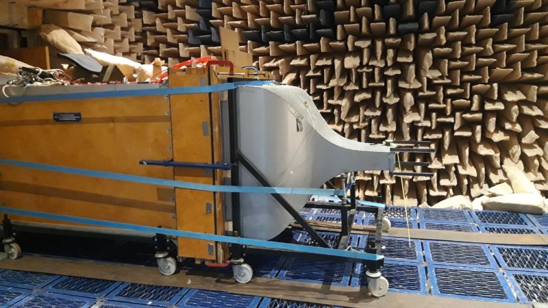

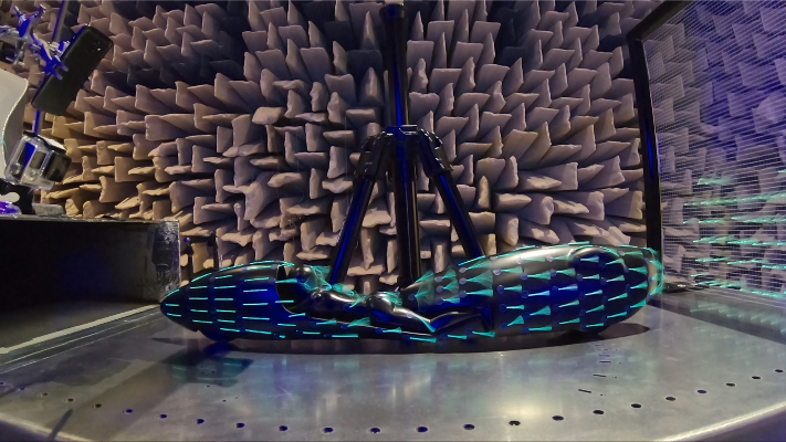

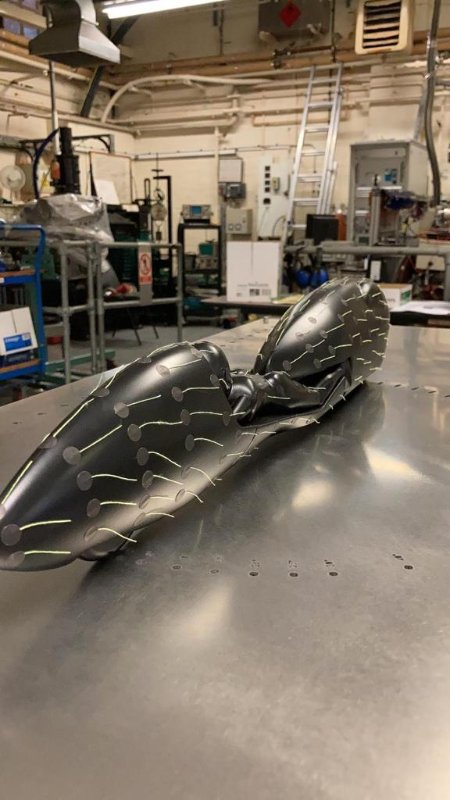

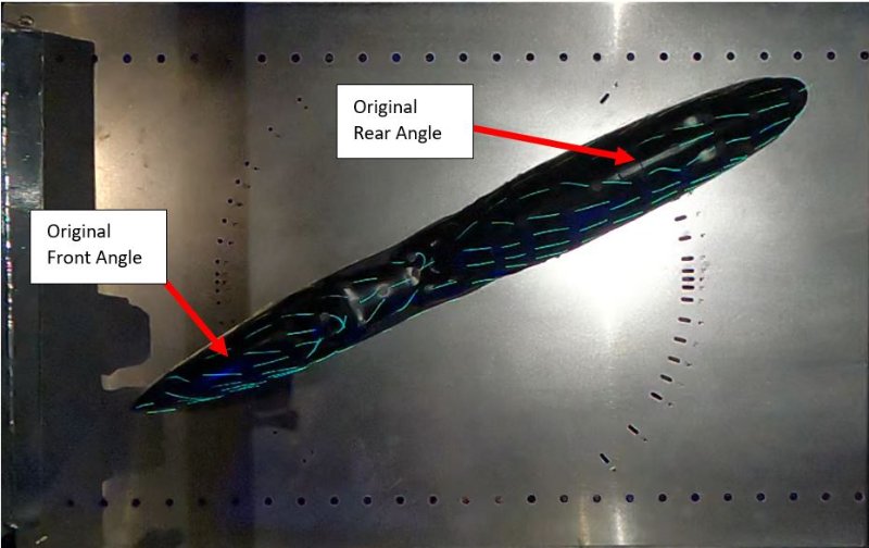

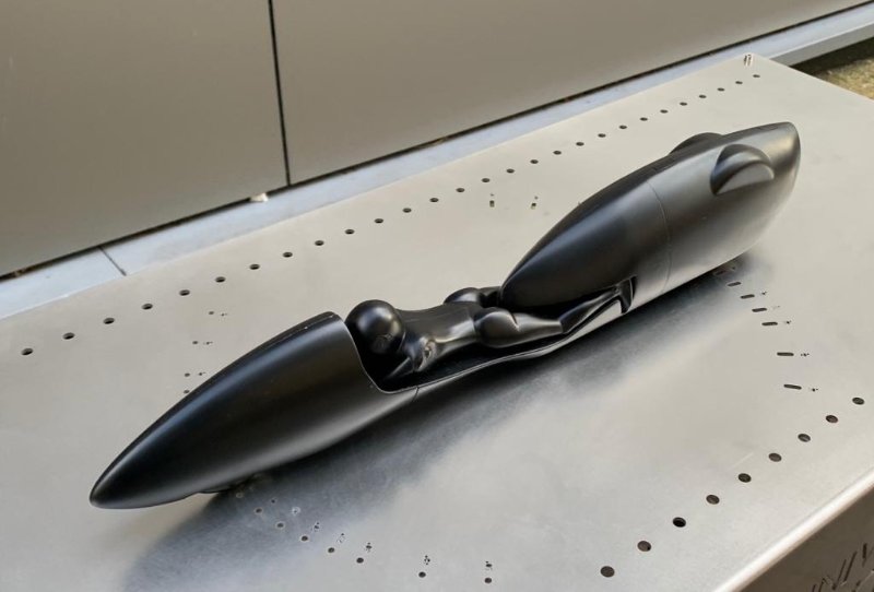

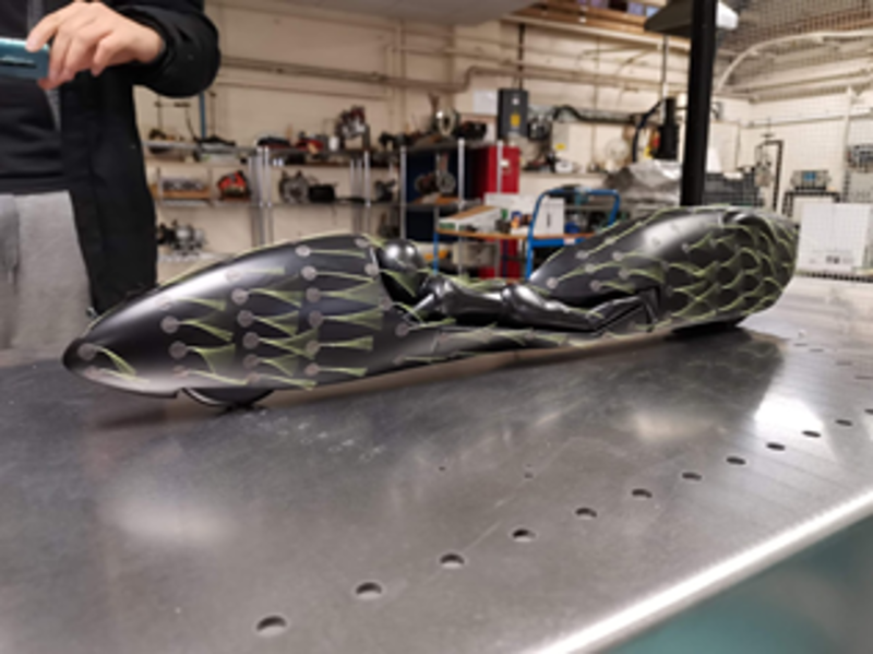

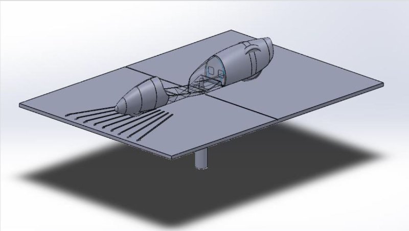

Next up we took our scale model and covered this in fluorescence tuffs for wind tunnel testing.
We built a special base plate that allows us to rotate the model to simulate cross wind affects.
Re: Fifty shades of Jade

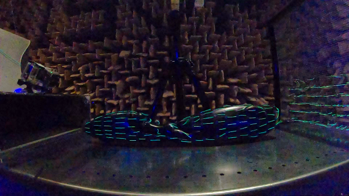

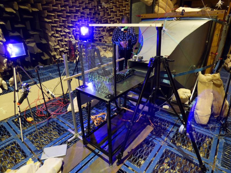

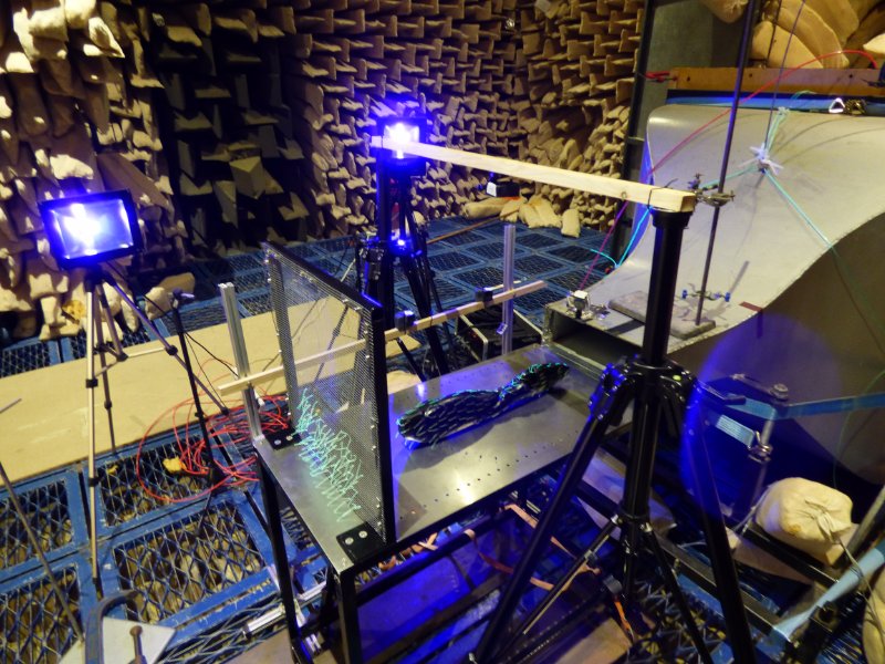

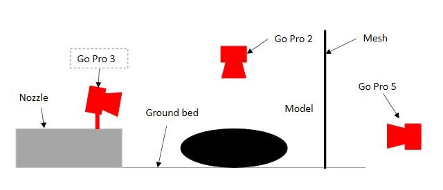

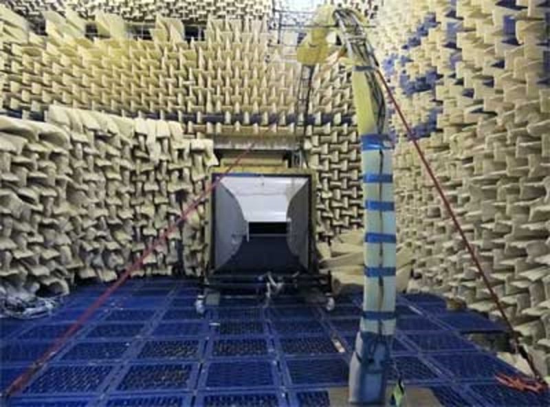

We then placed this model in front of a giant fan and left the room.
Cameras rolling we switched on the 100mph wind !
We are still looking at the data but it gives a very good visual aid to areas that need our focus

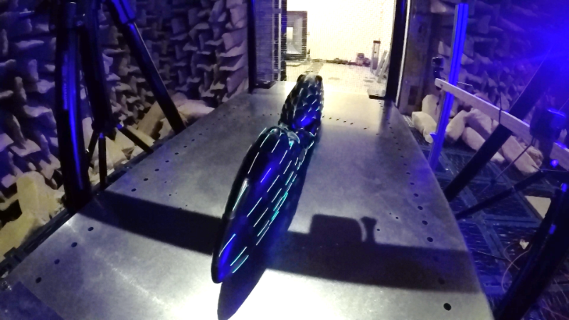

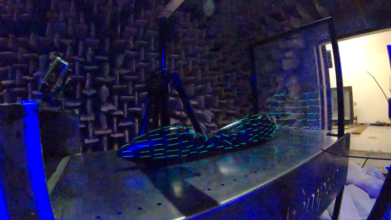

Testing cameras and UV lights!

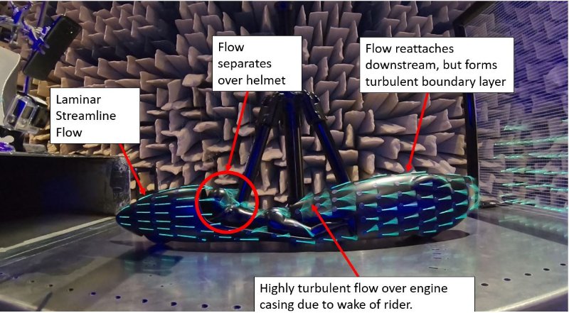

Just WOW.
So what conclusions thus far ? Is anything that flutters a problem ?
morgan wrote: Wed Jan 13, 21 4:29 pm Just WOW.
Pretty much :thumbright:
It's a good start and only early days, learning sooooo much every day
Posts: 4226
So do you want to send the air up/over the rider ? I assume you dont want to encase the rider in any way; although frankly its pretty much a missile anyway !
If you send it up-n-over creating a little vacuum for the rider how do you get it to reattach behind ? What a fun little problem (speaking as someone with zero knowledge of these things).
Keep us posted !

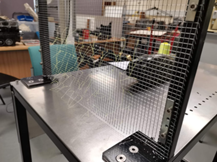

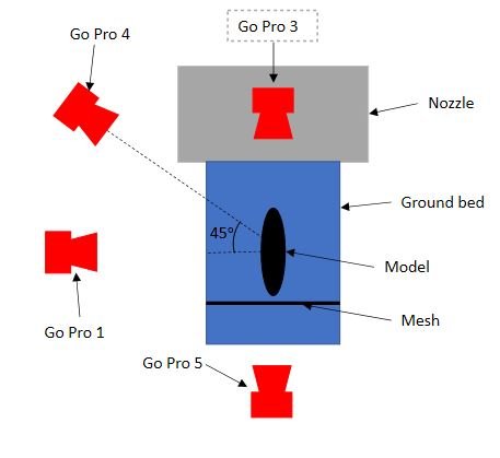

What’s the pressure drop of the mesh screen behind the model? It’ll affect the wake structure and change the trailing edge results.
I’m also not keen on how close to the top of the model the shear layer of the jet is.
For the speeds you are looking at you really want to be looking at a moving ground facility. But they are rare outside F1 in the UK.
Looking at the facility it looks like an NVH department rather than an aerodynamics department.
Tufts are good and we’ve done it a lot. Given the choice though I’d pressure tap the model.
Post by Bratfink »
Looking at those results there, you already know what you need to do to reduce turbulence behind the rider.
The bit I’m interested in though is the tuft on the leg. It’s showing strong outflow. That will interact with the wheel wake and increase the overall vehicle wake and thus drag. Figure out a way to get that flow more aligned.
