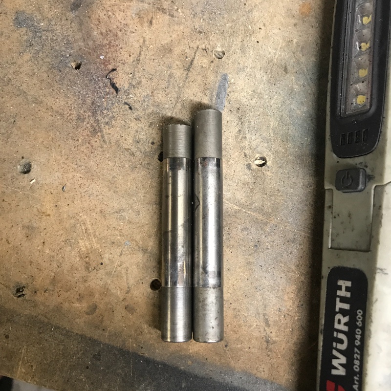

found my issue luckily had a spare one worn bigtime
still gonna renew pump though

Very common issue on big blocks. If you can believe what you read on the forums, the new replacements wear more rapidly than original parts.
Re: WHICH FUEL PUMP
Agreed, you can get some with different finished ends and different materials. I tried to use originals where possible.
I used to carry spare pushrods in the car - that's how much they can wear!!!

blimey didnt know that its an original one i have fitted🙏

Interesting, where do you buy just pushrods?

bought an ARP one to keep as as pare from amazon google 440 fuel pump pushrod and have a look at the options
