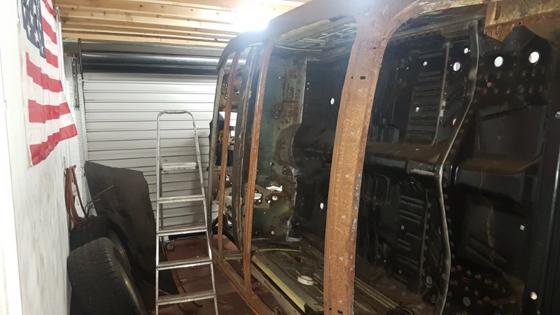

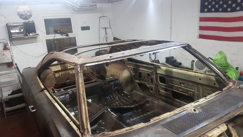

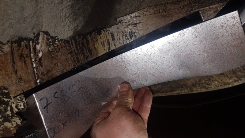

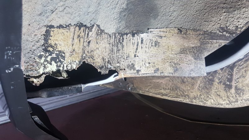

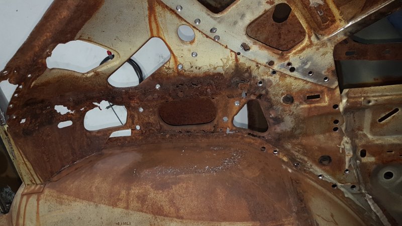

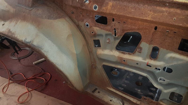

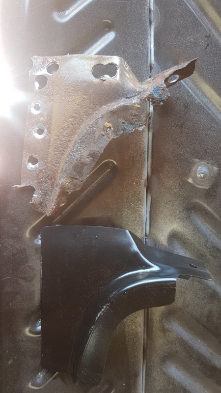

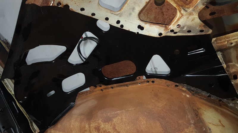

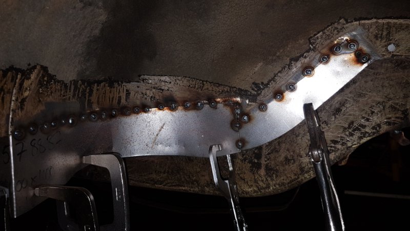

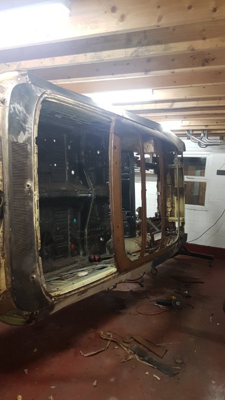

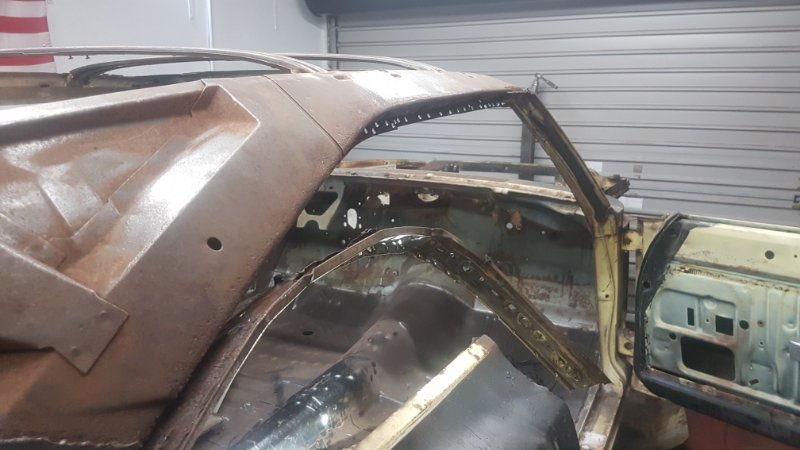

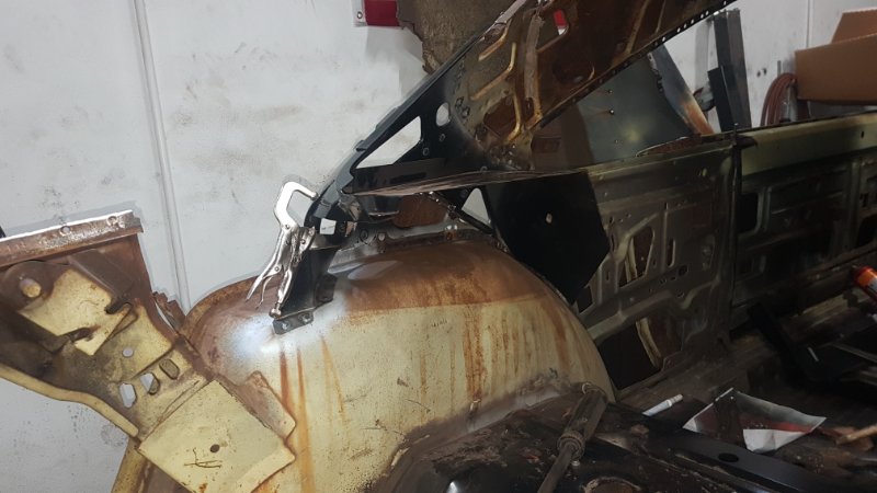

anyways pulled off both 1/4s and fix some of the mess under there,not to bad,replaced part of the inner roof structure above the left hand rear wheel house and replaced the shelf brackets.needed to replace the whole b post as some poor repair probably carried out years ago :pale:

:shock: crikey that's quite a chunk cut out.

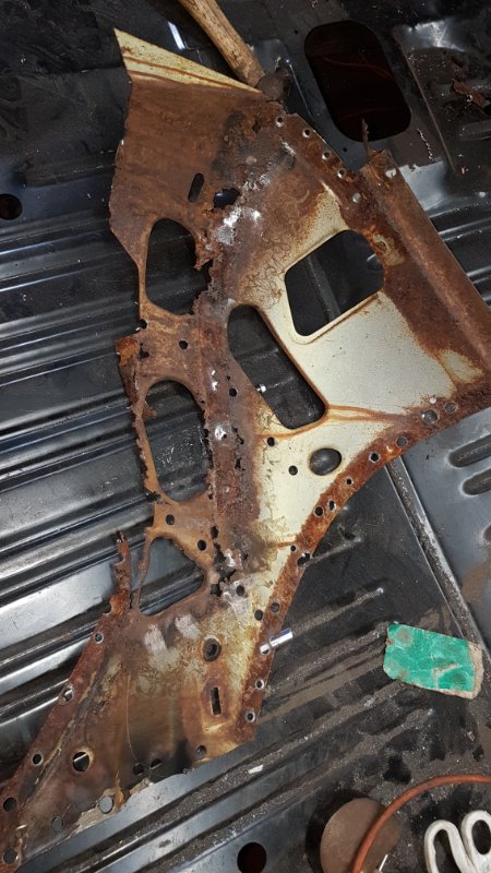

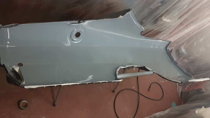

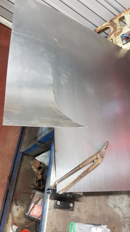

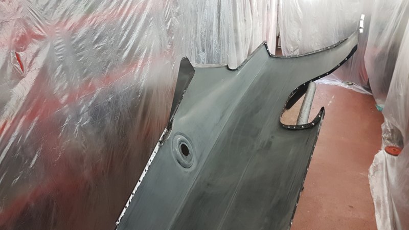

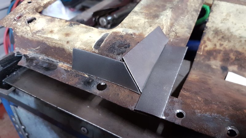

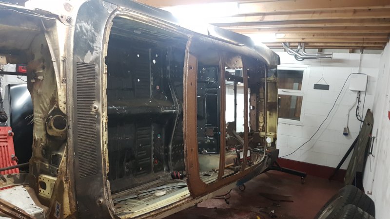

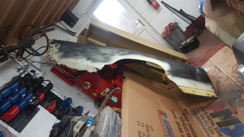

few small repairs to rear wheel tubs,rear rockers under the 1/4 skin were clean so prepped and epoxied,also prepped the rear 1/4 panels,some rear window frame repairs needed...

ScottyDave wrote: Wed Feb 23, 22 12:12 am :shock: crikey that's quite a chunk cut out.
sure is Scotty,she was quite rusty when i dug into her,would not take to long to empty a bank account for sure... :help: :thumbright:

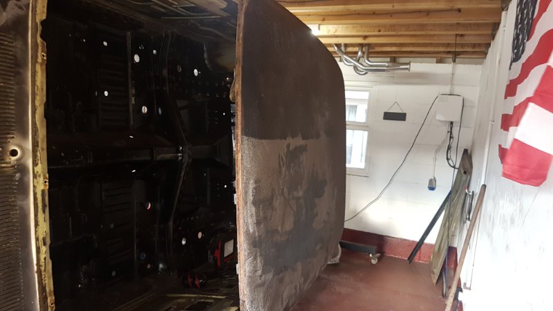

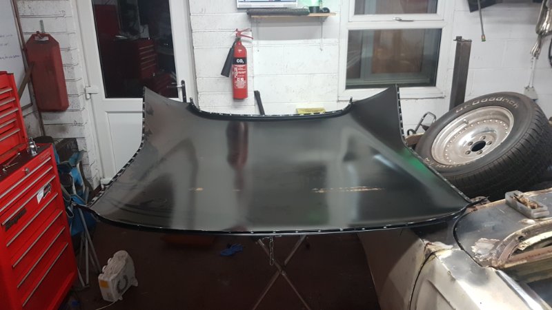

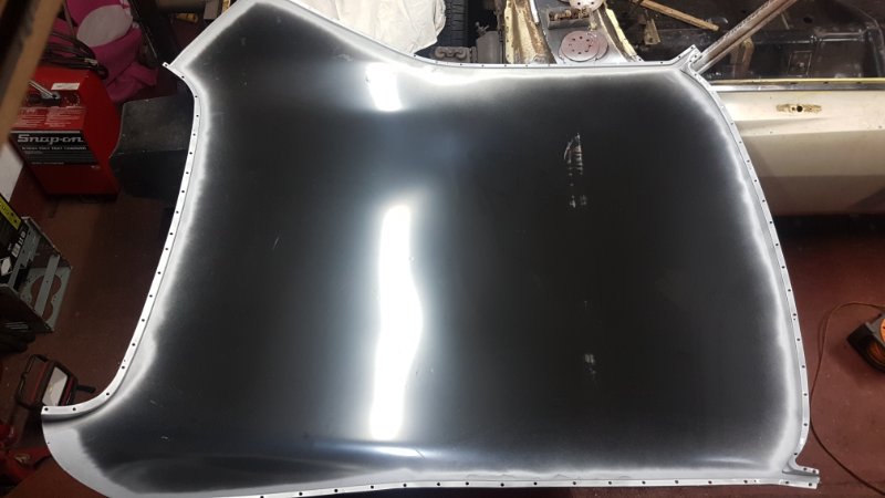

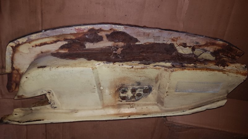

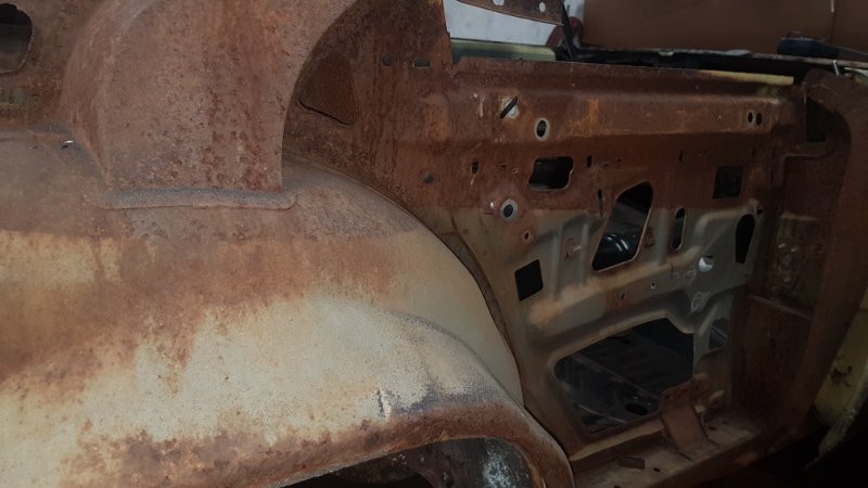

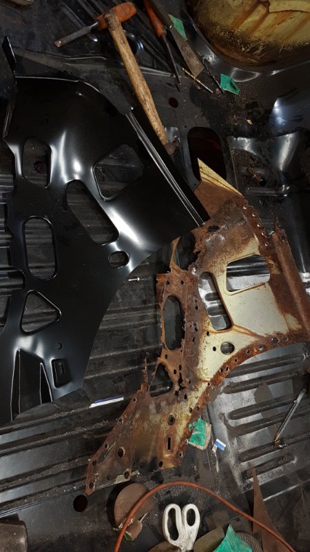

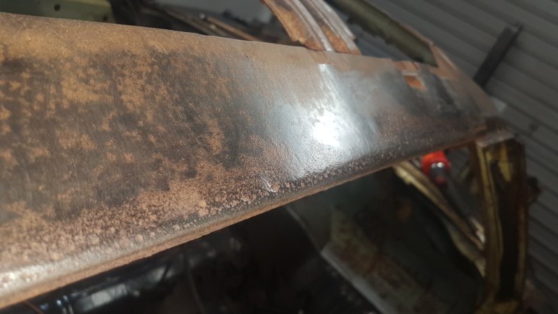

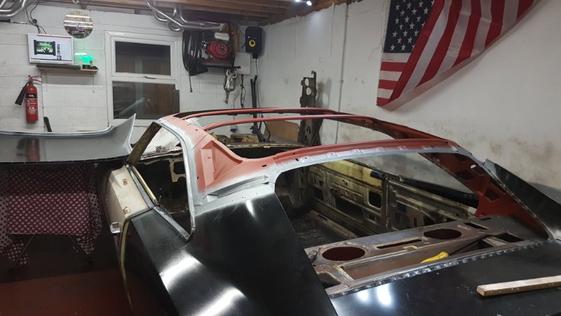

getting ahead of myself a little here(again)roof was heavily pitted thin and quite a few pin holes(vinyl top car).lots of cutting and grinding later turns out the roof structure was not in too bad a shape with only one small repair needed 8-)
Re: '68 Charger RT
Amazing wok, but I didn't know you could get all those internal panels now.
When I got into the hobby you could not even get quarter panels! It was NOS or cut-offs from crashed vehicles.

Pete wrote: Thu Feb 24, 22 9:51 pm Amazing wok, but I didn't know you could get all those internal panels now.
hi Pete yep agreed,did one of these around 10 years ago and nothing available,luckily it needed only frame work and outer 1/4 skins which were nasty at that time.id heard before lockdown that AMD where looking for the main roof inner structures to replicate which would be great [-o< :)

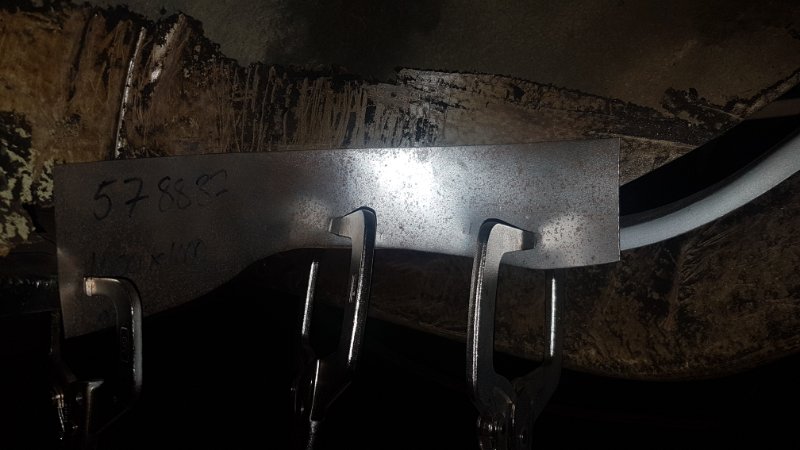

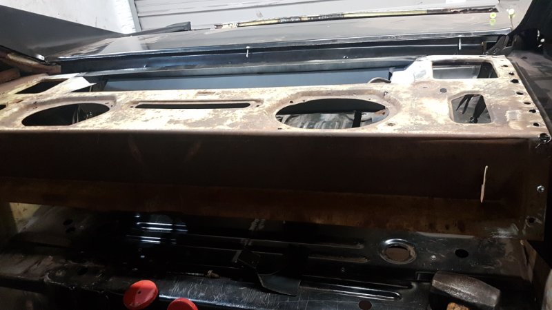

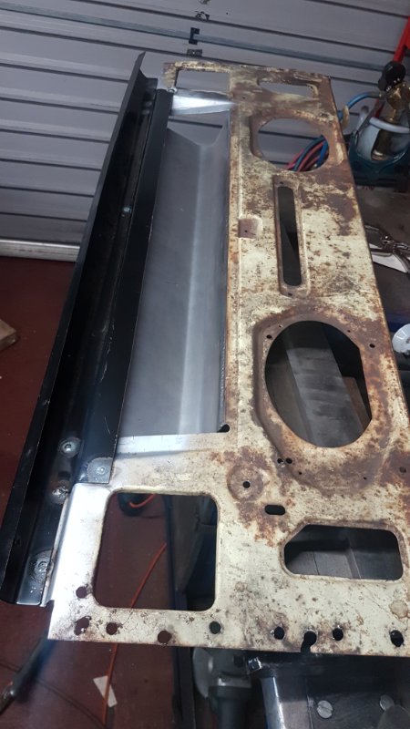

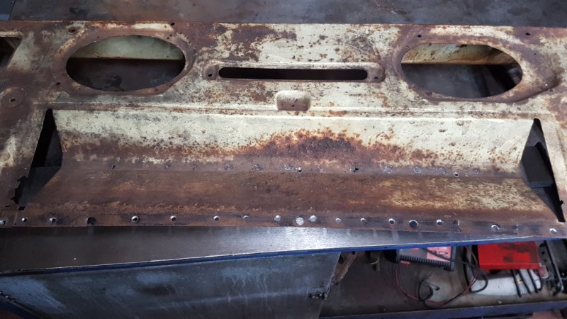

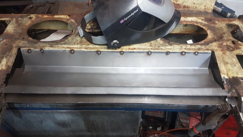

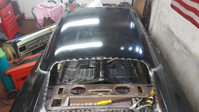

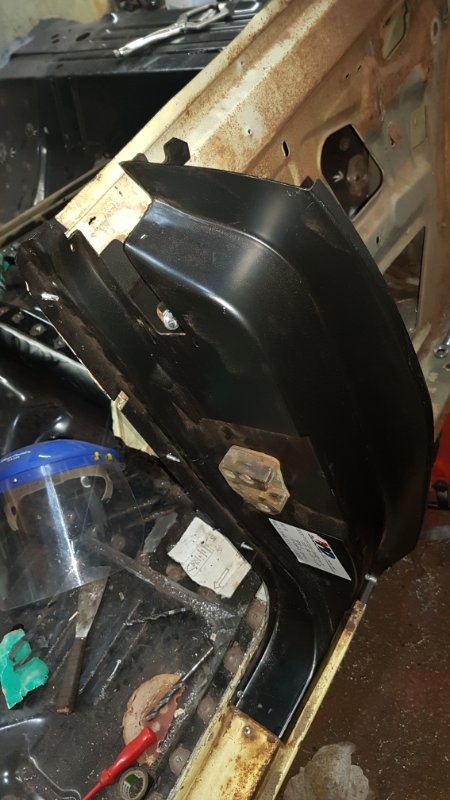

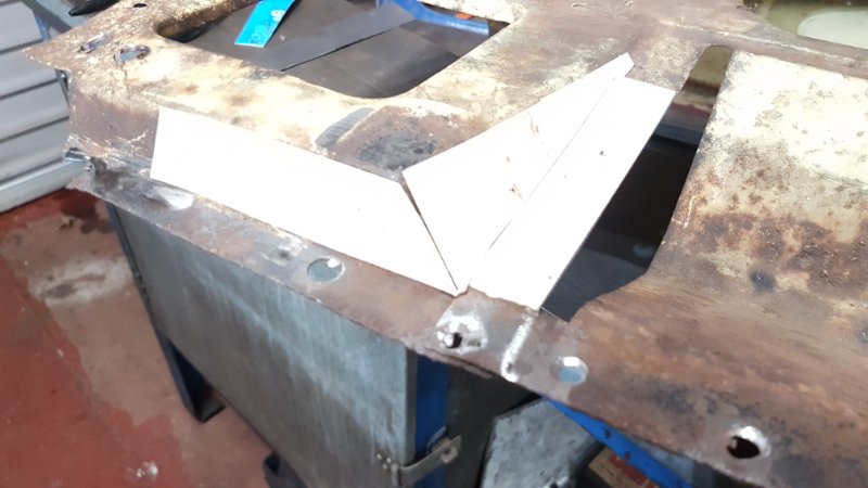

rear parcel shelf was a little corroded and did not have this piece so decided to carry out a couple of repairs,turned out great :D

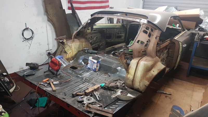

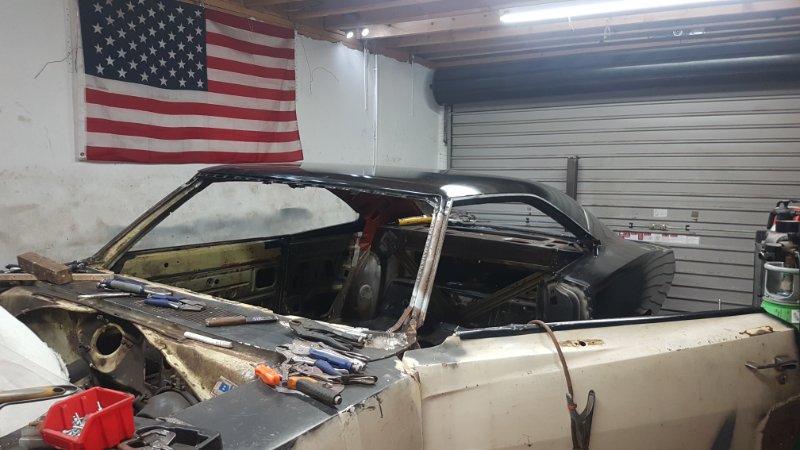

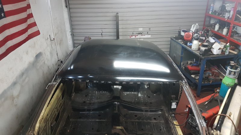

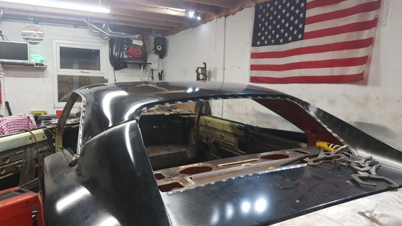

cleaned and prepped then used epoxy on the rear then finally wrestled the 1/4s into position then roof install,looking like a car again at this point
