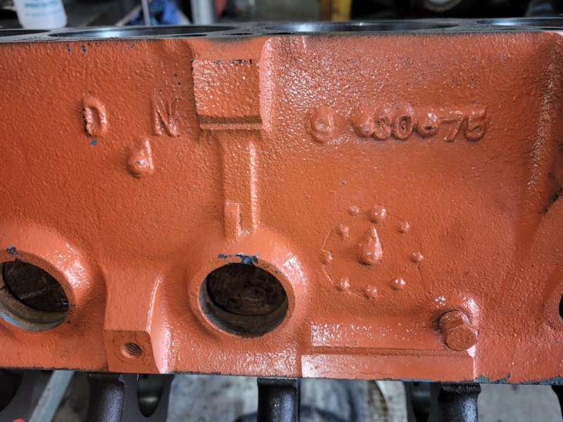

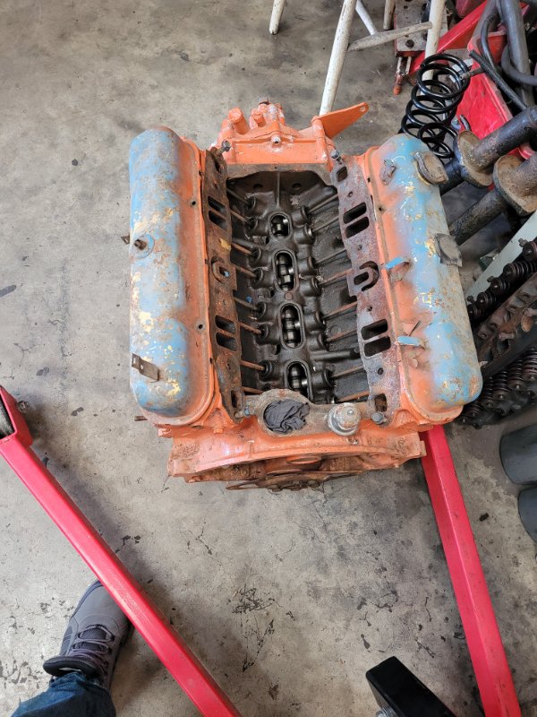

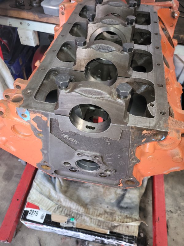

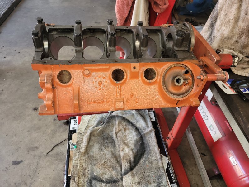

Well its been slow progress on the motor due to various factors. But, this week we have been able to open up the 318 so we can have a look and see what the internals look like. Great news its in good condition for a 75 block and is on standard bore.
So I can now start ordering parts.
Well......I could if they had any in the US.
Spoke to Hughes this week and found that they are short on Pistons, lifters and the rocker assembly. No option but to order and wait. Not in any rush, but would like it on the road for next spring. Good thing is it's a spare engine so the car can still be used while all this is going on.
So it's back on hold until Diamond send some pistons through to Hughes. Without these no point in having the block machined and bore taken out by 30 thou.

As you can see in the above pics, some cleaning to do with the dremel, especially around the valley.
One of my big decisions over the last 4 months was what to do regards parts selection. I know I want 400HP and over 400ft lbs TQ, but many ways in which to get that.
Ideally want low 12s in the 1/4 but for it to still be street friendly.
Well this is what I've settled on after lots of conversations with knowledgeable people and guys in the US.
Engine Build: 318 taken out to 390
Scat cast crank (4") and rods.
ARP everything on the bolts.
Diamond forged pistons (16.7cc) at 3.940"
Eddy RPM 60779 Cylinder heads (63cc standard) c/w felpro 1008 head gaskets (0.039 squish).
Hughes Cam - Solid flat tappet - HUG STL4246AS-8 and lifters
I've calculated 9.9:1 SCR at 0 deck Low 8's DCR
Hughes 1.5 Rocker assembly
750 Mech carb (holley or brawler)
1" phenolic spacer
Eddy RPM Air Gap Intake
Eddy Fuel pump (mech)
Melling HV oil pump and drive
Milodon sump
Howard's timing set and tensioner
Ali water pump.
Dougs Headers
MSD pro billet Dizzy and Digital 6AL.
Windage tray or scraper still to be decided on.

Dave, if you want to open up the oil galleries I have the required drill and reamers. Not strictly needed but I thought it was cheap insurance. Grinding out the main cap to oil pump join is also a good idea.
Re: Dave's 72 Dart
Yes, good idea Blue, well worth it.Blue wrote: Sun Aug 14, 22 11:39 am Dave, if you want to open up the oil galleries I have the required drill and reamers. Not strictly needed but I thought it was cheap insurance. Grinding out the main cap to oil pump join is also a good idea.
Go for it Dave
Re: Dave's 72 Dart

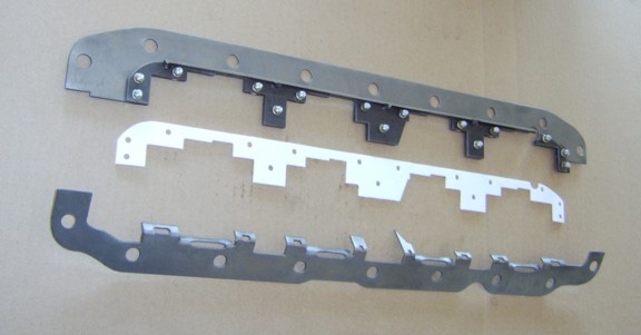

I don’t rate windage trays, Teflon crank scraper is my choice, had the other style on my 360.

Glad it turned out to be good.

Thanks John, I will let you know if and when.Blue wrote: Sun Aug 14, 22 11:39 am Dave, if you want to open up the oil galleries I have the required drill and reamers. Not strictly needed but I thought it was cheap insurance. Grinding out the main cap to oil pump join is also a good idea.
Re: Dave's 72 Dart
Can you ping me a link to where you got yours from please?Blue wrote: Sun Aug 14, 22 1:55 pm I don’t rate windage trays, Teflon crank scraper is my choice, had the other style on my 360.
Re: Dave's 72 Dart
Yes it was exactly what I'd hoped for when it was opened Stu. A great basis for some tyre smoke....
