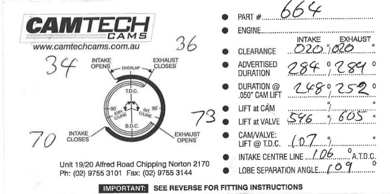

find an old PC and run mr kellys caluclator with your numbers and aim for a cam that gives you 8 - 8.5 :1 DCR
start with a standard hydrulic or soild and just keep changing the cam spec until the end calculation gives 8-8.5
once you have done that you have ballpark for lift duration centrline and the lobe speration angle and can choose your cam from wherever
i ended up with this
cam card.jpg (65.56 KiB) Viewed 1176 times
