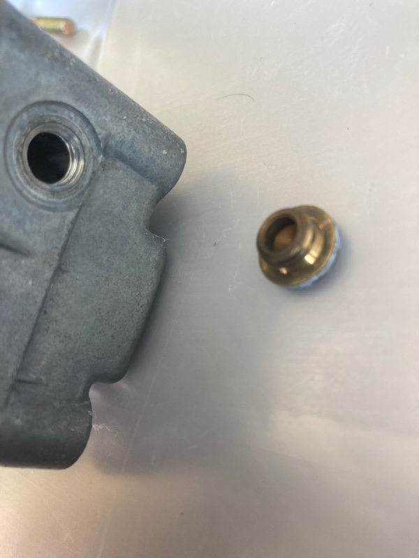

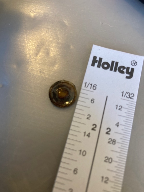

I don't recognise that, is it like a brass disc or something?
Posts: 22109
The one top right is probably a Shooter gasket.
The other looks like a Float Lock screw upside down, cannot really tell from the picture.
There will be lots of "spare" parts in a gasket set that you will not use as they are "universal" which is code for "Fits nothing!!"...
Posts: 7111
Not 100% sure what it is Blue, but think it’s fibre and got some sort of adhesive or sealant on it.
Posts: 7111
Pete wrote: Sun Apr 24, 22 10:18 am The one top right is probably a Shooter gasket.
Top right one wasn’t meant to be on the pic, sorry! :lol: you are right though, it is a shooter gasket. :thumbright:
It’s the little round disc that’s got me confused.
Nope, no idea!
Posts: 7111
:lol: Looks like it isn’t going back in then! :-#

Next dozy question… should there be an o ring or something around the fuel bowl sight plugs? Doesn’t look like there was in the photo from when I took it apart, can’t tell from the diagrams, but the slight recess in the outside of the bowl suggests there should be something. Can’t find a perfect fit in the kit, though. Closest are the ones below . :scratch:

In the meantime, I found this in the kit, which looks very much like the disc we we’re trying to to work out earlier… :-k
Still don’t recognise it! Is this a 600 carb?
