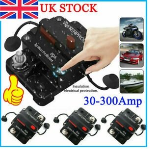

Good afternoon all
After a scary moment with putting a screw into a heavy powered wire. :pale: I am going to fit a failsafe on the battery power lead.
My battery is in the boot, so I have a long big power lead from front to back.
Am thinking of fitting something like this pictured, unless someone has a better alternative? My question is, what kind of amps will the starter pull? , I want to make sure the car is protected, but not trip out all the time on starting up :cry:
Thanks 8-)
https://voltaconsolar.com/breaker-inlin ... -150a.html
https://www.ebay.co.uk/itm/256009780497

I have 2 installed in the Race Challenger and they saved my bacon at the track (at the cost of a Q2 run) when an alternator went short circuit and the wiring loom nearly went up in smoke. Just diagnose and reset. Simples.
I heartily recommend them or similar....

Ooh. I like this idea.

Dont buy this one, it looks as big as the battery going by the guys hand :lol: [-( :-k

He has the hands of a lady..!
