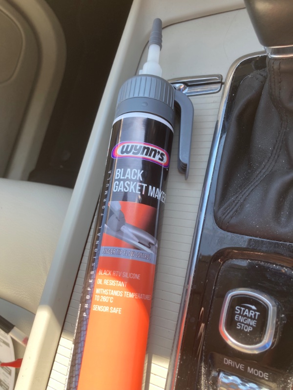

Since it was recommended to me, I’ve used nothing but Wurth Super RTV High Temp Silicone.
Got a job to do tonight and as it’s the first one using it for a while, it’s gone off. Quick Look around and I’m struggling to find it now, Wurth Trade Centre near me won’t deal with me as I’m not trade and can’t find a stockist.
I’ve ordered some Permatex Ultra Black as a back up, but as I need to do the job tonight (Intake Manifold, so a thick bead at the ends required) I dropped into the local Motor Factors and all they had was Wynns Black Gasket Maker.
It all looks and sounds the same to me, but as I haven’t had an issue since switching to Wurth, it made me wonder.
Is it? :-k
