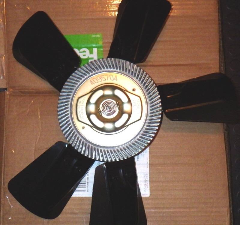

The long discontinued Mopar performance viscous fan kit has long been my weapon of choice, great cooling without much HP draw. It is possible to replicate using parts from Hayden https://www.haydenauto.com/media/5587/i ... -pages.pdf
- IMG_2008.jpeg (144.08 KiB) Viewed 67007 times
