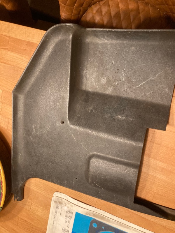

What’s the best way you have found to restore interior panels?

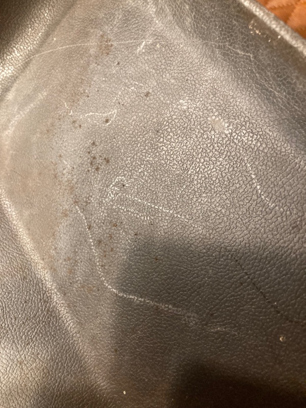

Mine are, for the most part, in good overall condition. No lumps out of them or significant damage, but they are faded and have “ugly spots” and some swirls and surface scratches.
I’ve used autogym sprays with some success, which brings them up shiny and black for a while, but more slippery than a greased up stripper and doesn’t hide any of the surface damage.
Interested to know if there is a way of bringing these up that doesn’t involve flaky paint or owt like that.
Here to learn, hit me up! :read2:

id clean em with a nice stiff washing up style brush and have a good look when slick and wet get an idea of what they look like with a gloss finish
the scratches may not be as evident as you think.
amazing what solid colour does, once the white witness marks from scratches is covered, i'm sure they will look pretty good
