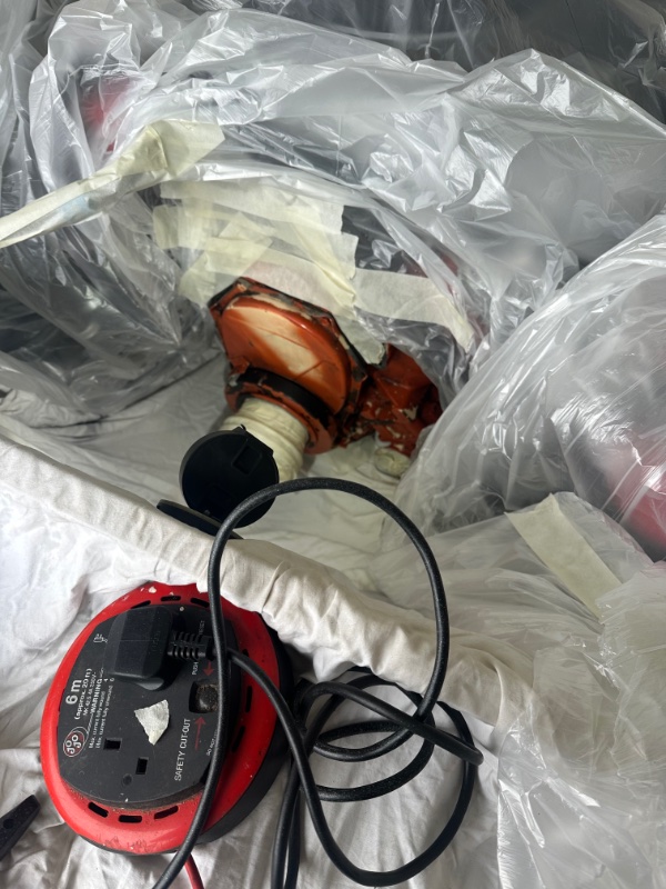

Mine is a mixture of various shades of orange and some black parts.
Was looking on a few other forums and brushing seems to get good results.
I’ll degrease, scotchbrite as much as I can and then get to work with a brush.
I’ll wait until the temp comes up though.
I don’t think it will look any worse than it does now.
Re: Engine painting
I’ve done a fair bit on mine in situ,as Dave says lots of masking and various things removed.
I used VHT in orange and black,with regular satin black for non heat affected parts.
What I did find useful was body shop masking film in a roll,great for those tight spaces.
Brushing in some areas is inescapable,and heat to prevent reactions and runs is essential.
Polish that Ali don’t forget 😉
