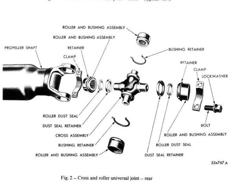

the caps and contour of the yoke take the strain, if the caps stay in the yoke these little bolts see little stress.
the straps are just there to keep the cap in position they are not in any way directly taking the load applied by the motor

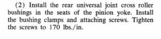

Aussie service manual
small dodge UJ
pressed, flat strap UJ clamps 170 LB/In (inch not foot)
small dodge UJ
these are tiny bolts with an imperial size look to be some where in the 8 - 11 mm size range

Cheers Dave.
Sounds like 15ft lbs could well be right, then.
