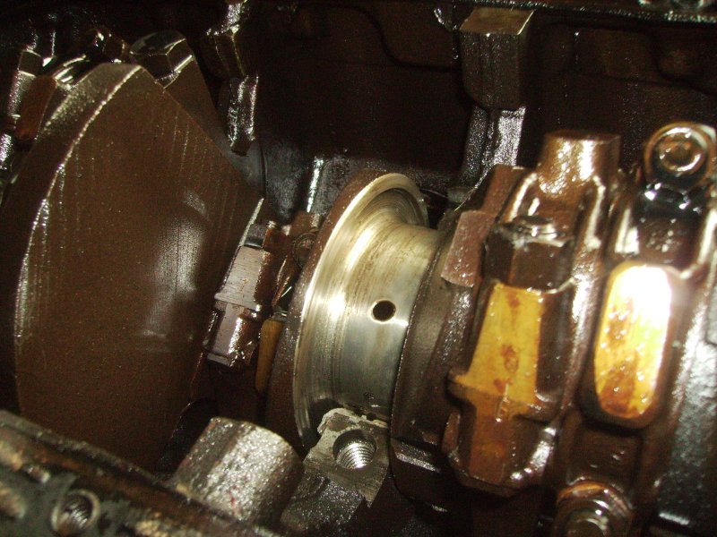

so we started removing parts from my fe engine to swap some new parts in and refit the 4 barrel inlet. after whizzing the damper bolt off it's always giving them a bit of a tap with a rubber mallet before getting the puller out, you know just in case. anyway a couple of taps and it moved forward about 1/8" ish and i though that moved easily. so we gave it a tug/wiggle and nothing then we noticed it moved 'back' the same 1/8" ish. ohh noooo!. it was at this point i remembered something my dad said from time to time...... ''just when you think it's going ok you get the obligatory kick in the bo11ocks!''. that's where we're at now as that movement is crankshaft end float. i spoke to ash' this evening and he's going to have a think about where to go from here. initially he said he'll collect the car and stick it back in his garage. then he'll save up to build the full chassis and the 440 mopar engine the car was meant to have this time anyway.

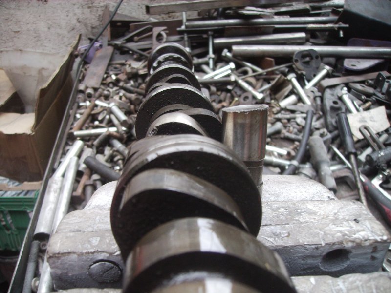

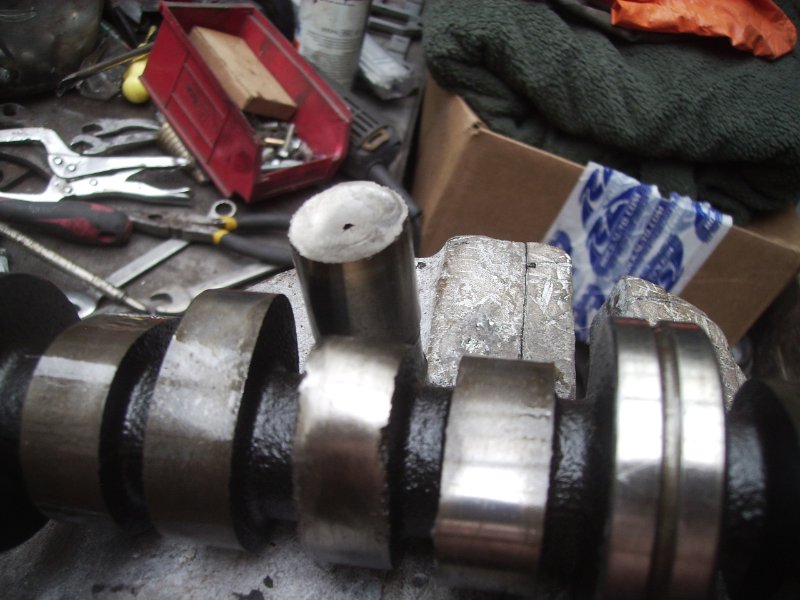

yesterday we got my fe engine up on the engine stand and turned over to open up the bottom and investigate the crankshaft's excessive end float. well the engine must've come from a manual galaxie i reckon as the thrust part of the main bearing has worn into the crank' almost 1/8"! so although i could weld and turn it flush now i have my bigger lathe, with 2 other engines here we'll just sw2ap in another crank' with new bearings and call it good. we'll still swap the new roller timing set and h/v oil pump from ashley's engine but other than that it'll remain stock. here's a pic of the crankshaft carnage

today we got the spare short block out of stock to check the crankshaft. from what we found on taking it apart this one was/is a1960 352/360hp engine, cool. anyway the crankshaft journals are all good and standard so that's the one we'll use. the bores are good too so a nice spare block to keep in stock.
