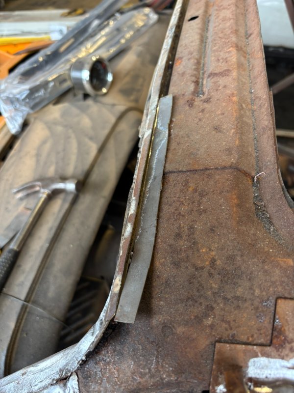

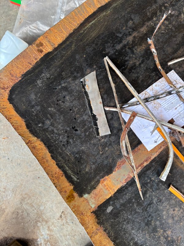

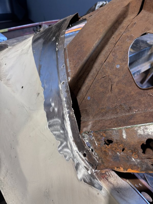

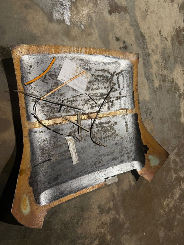

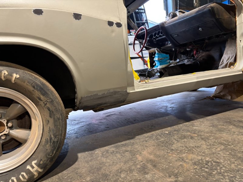

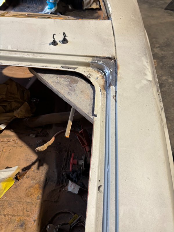

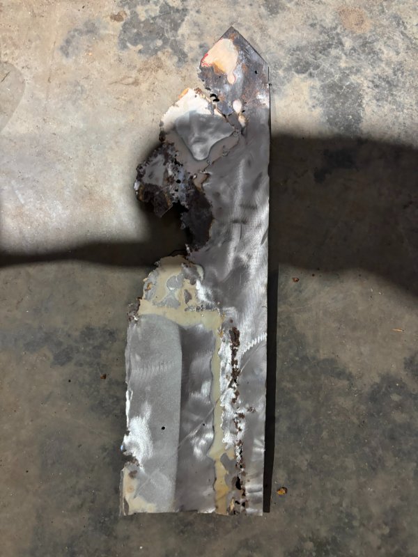

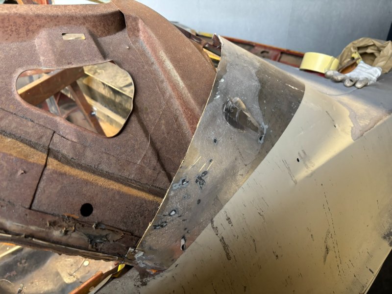

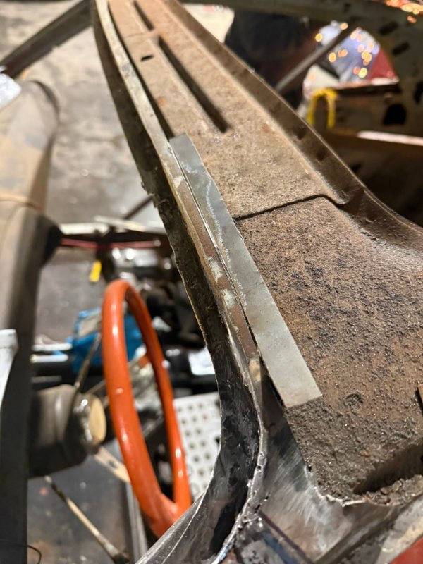

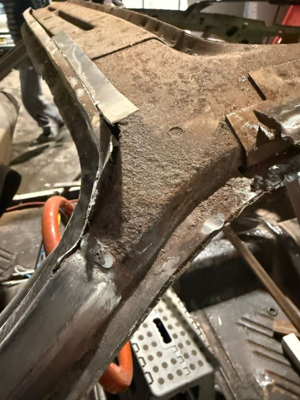

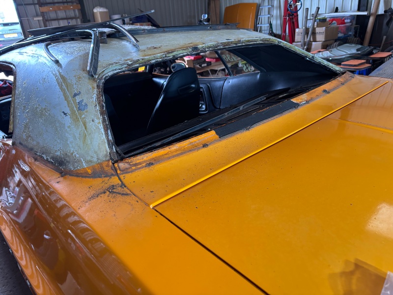

Posts: 7183

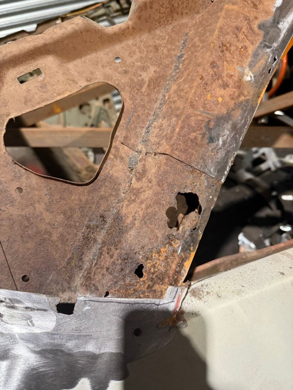

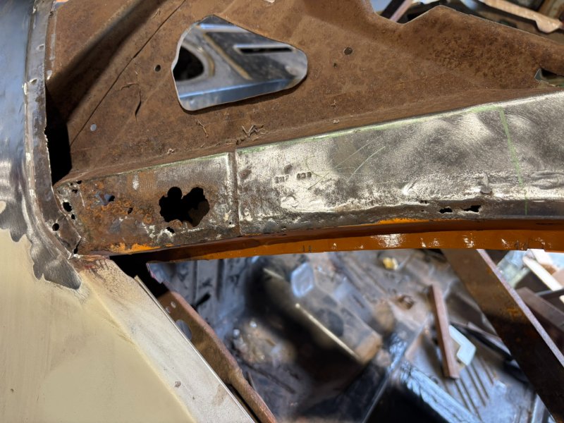

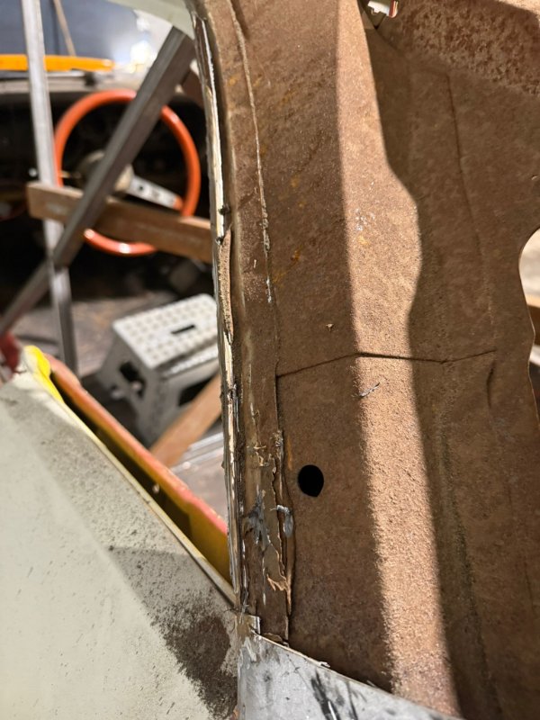

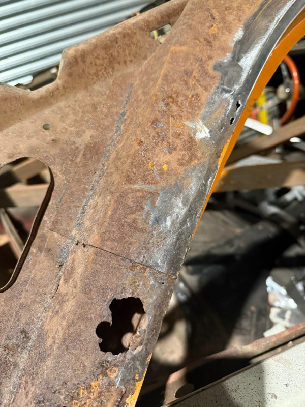

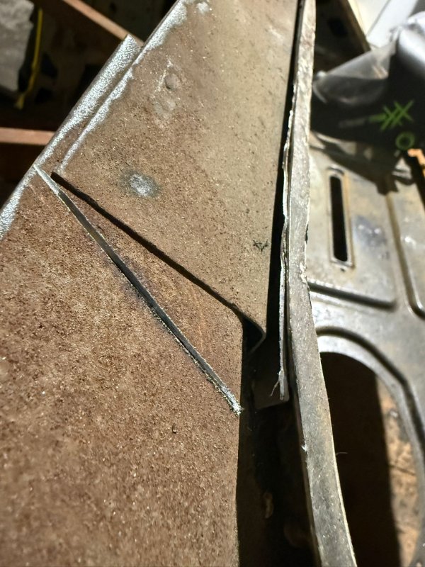

I should probably update, as there has been a lot going on.

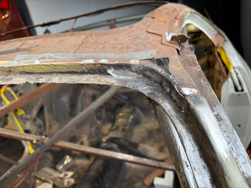

The short version is, the roof was not in good condition at all, despite looking like it wasn't too bad.
Never seen bodgery like it. It had not only had a replacement wonky centre section badly welded in, but the welding was complimented by what looked like a mix of filler and sealant, before being brush painted over from inside and sprayed over from outside. Further enhanced by strips of untreated steel being hammed into gaps and sealed in to bolster it, it was an absolute disaster.

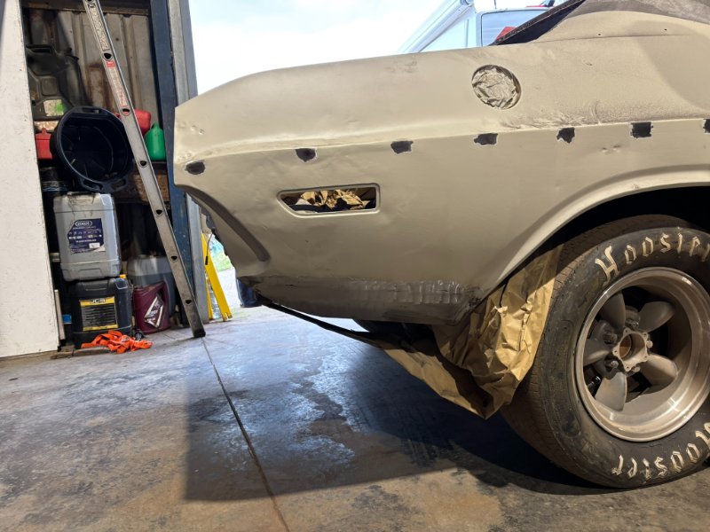

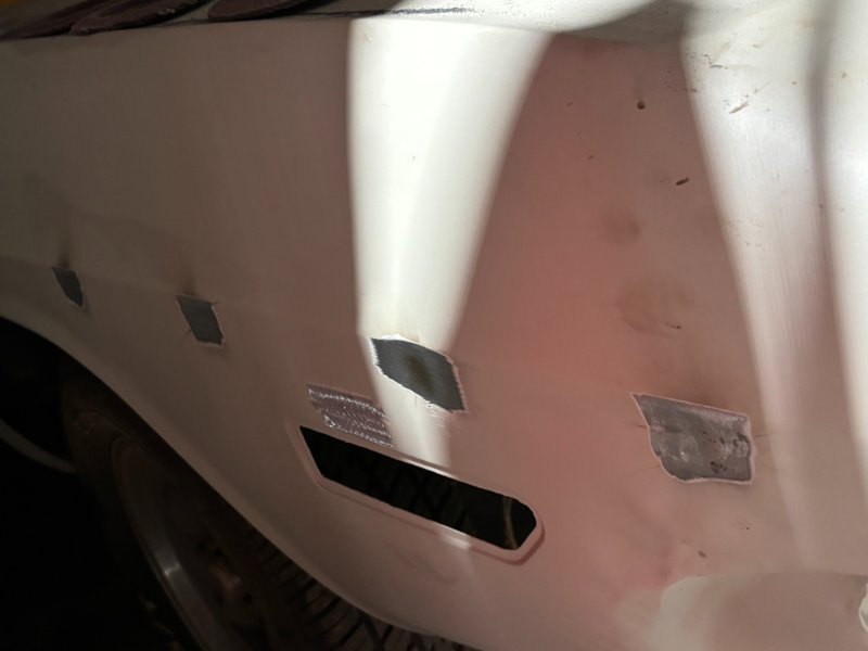

After very little thinking at all, it was decided that I will have to park the new engine build and do this properly instead, so finished stripping it, had it epoxy primered and pushed it round the corner to a proper welder to start patching what we already knew about whilst I emptied my wallet for a new roof skin...
Some random pics of the early patching taking shape and a sample of the multi-patch grot that was cut out of one of the rear quarters...
1. Early patch repairs.JPEG (42.28 KiB) Viewed 3871 times
2. Early patch repairs.JPEG (104.4 KiB) Viewed 3871 times
3. Early patch repairs.JPEG (114.48 KiB) Viewed 3871 times
4. Early patch repairs.JPEG (101.42 KiB) Viewed 3871 times
5. Early patch repairs.JPEG (109.23 KiB) Viewed 3871 times
6. Early trunk repairs.JPEG (94.73 KiB) Viewed 3871 times
7. Patches on patches and rot removed.JPEG (94.02 KiB) Viewed 3871 times

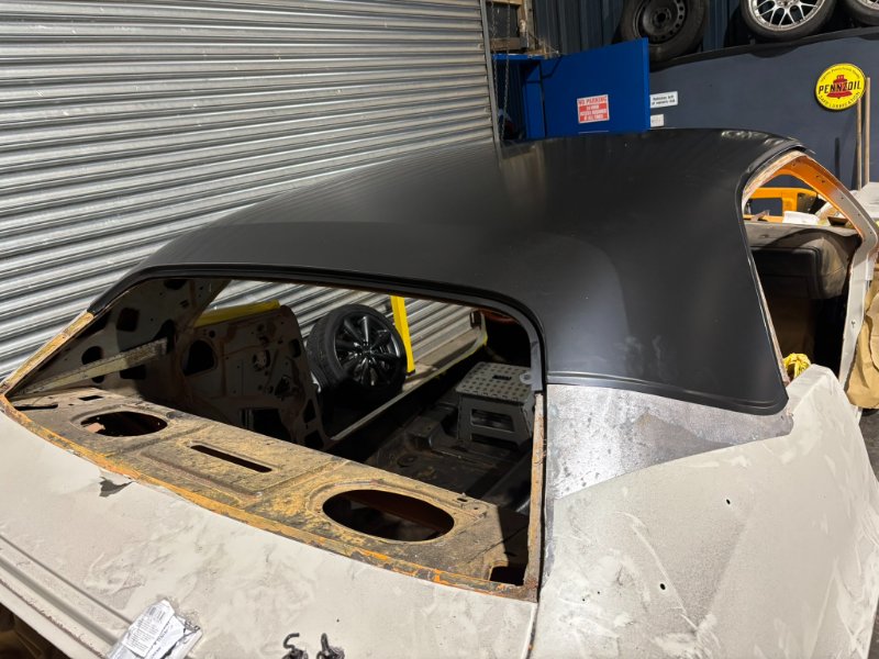

Posts: 7183

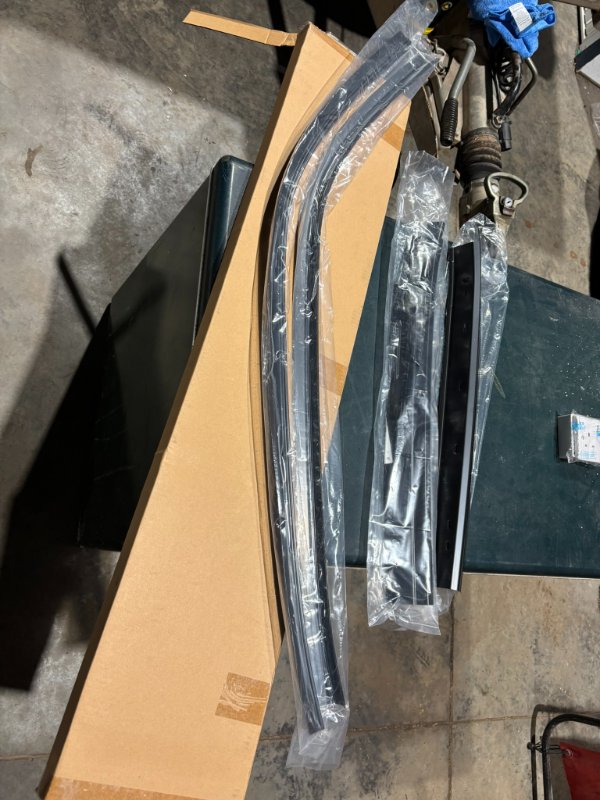

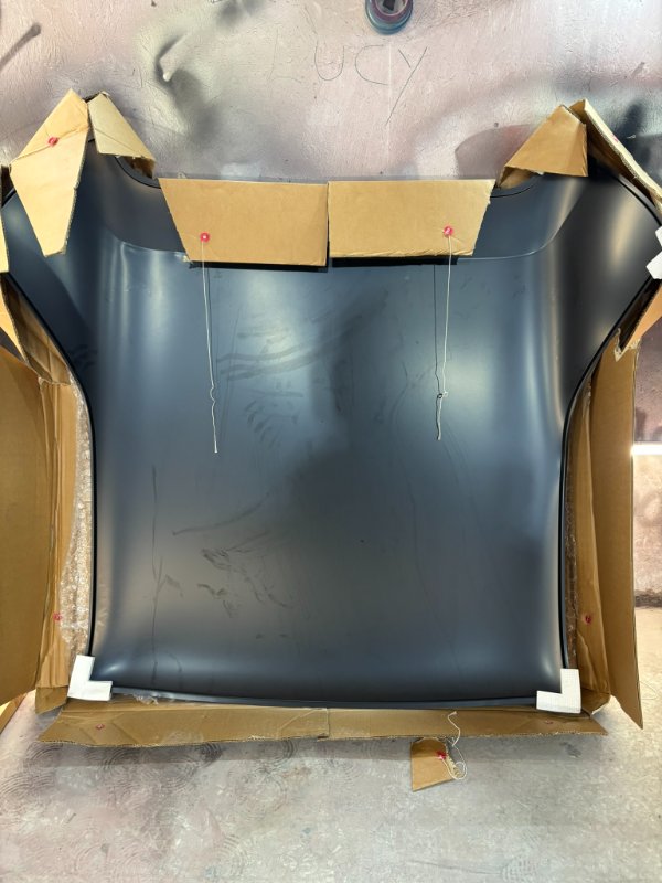

While that was going on, Chris Goodale managed to get me a roof skin, outer roof rails and drip rails in double quick time! Epic service as ever.
8 hour roadtrip in a van later and the new skin was flopped on top for a quick check before bracing and cutting began.
8. New Roof Panel.JPEG (84.39 KiB) Viewed 3866 times
9. Outer roof rails and drip rails.JPEG (111.67 KiB) Viewed 3866 times
10. New Roof Panel Check Fit 2.JPEG (118.26 KiB) Viewed 3866 times
11. New Roof Panel Check Fit.JPEG (109.87 KiB) Viewed 3866 times

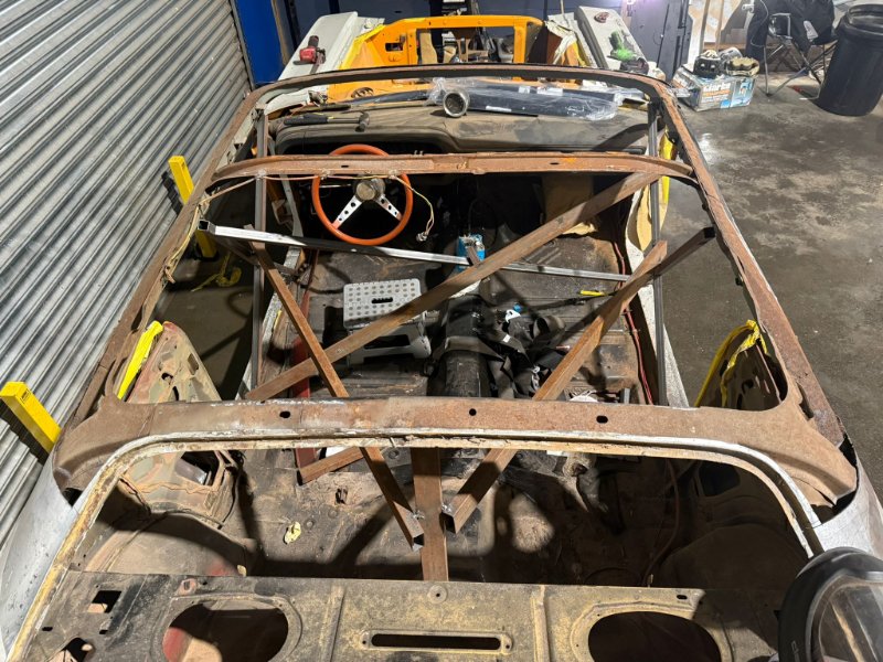

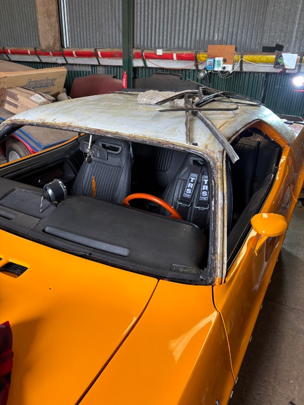

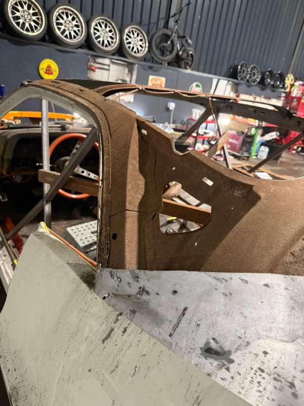

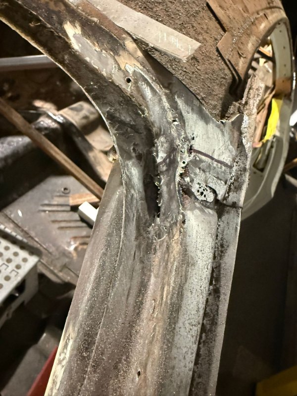

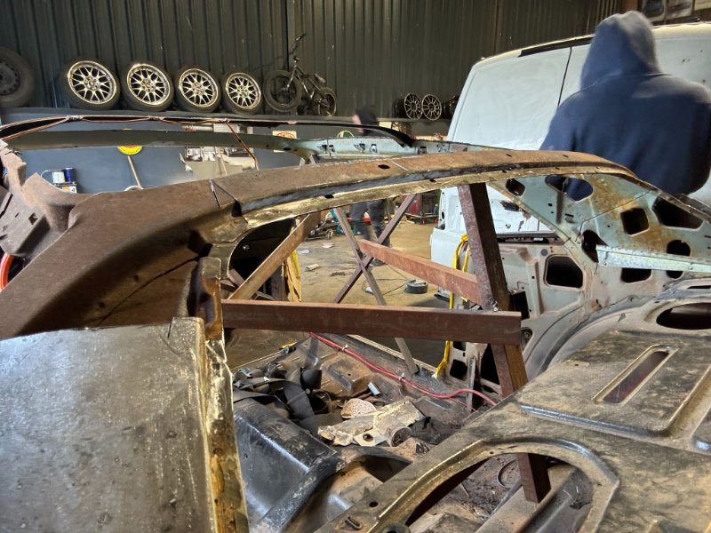

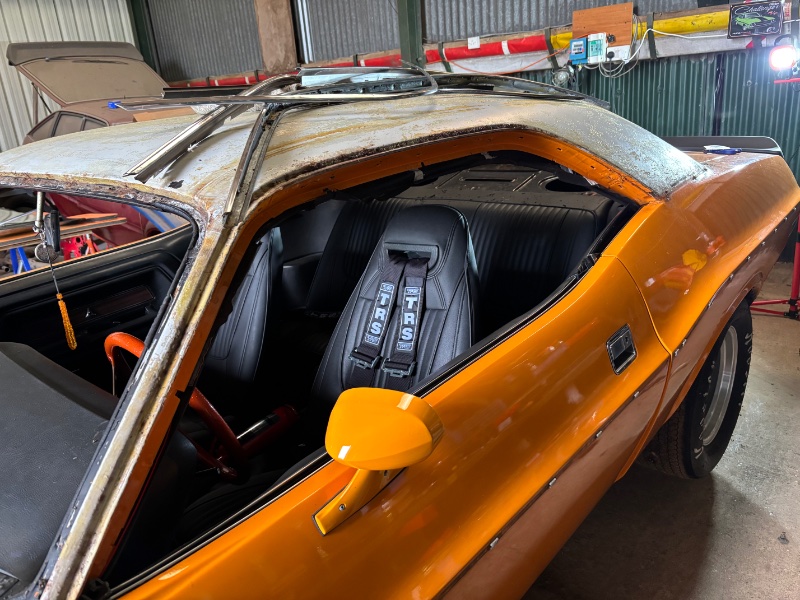

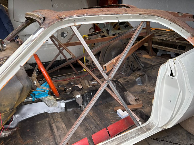

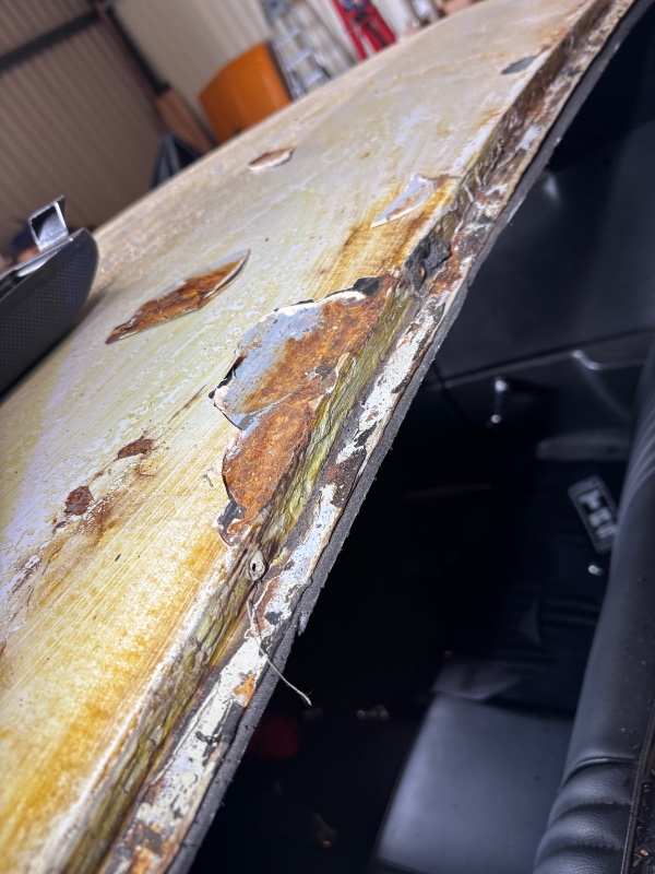

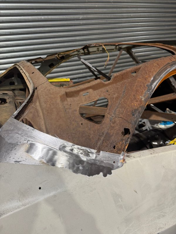

From there it was a case of starting to dig out all the rot, brace the crap out of the car and cover my eyes while a much more competent welder than I removed the roofskin... :help:
A selection of pictures for your delectation, of random holes, bodges, bracing and grinding. This was an arse-puckering point in proceedings for me.
12. Roof removal uncovering bodges.jpg (100.51 KiB) Viewed 3859 times
13. Roof removal uncovering bodges.jpg (110.96 KiB) Viewed 3859 times
14. Roof removal.jpg (103.25 KiB) Viewed 3859 times
15. Roof removal grot.jpg (95.33 KiB) Viewed 3859 times
16. Oles.jpg (111.91 KiB) Viewed 3859 times
17. Skin Off.jpg (138.51 KiB) Viewed 3859 times
18. Skin off Closer.jpg (143.34 KiB) Viewed 3859 times
19. Grot.jpg (115.15 KiB) Viewed 3859 times
20. More oles.jpg (112.85 KiB) Viewed 3859 times
21. Roof Off.jpg (123.1 KiB) Viewed 3859 times
22. Roof Off.JPEG (150.27 KiB) Viewed 3859 times
24. More still.jpg (118 KiB) Viewed 3859 times
25. Bracing.JPEG (131.67 KiB) Viewed 3859 times
26. More bracing.JPEG (126.5 KiB) Viewed 3859 times
27. Lead removal.JPEG (100.33 KiB) Viewed 3859 times
28. Oles and more oles.JPEG (117.24 KiB) Viewed 3859 times
29. Digging out more lead.JPEG (102.64 KiB) Viewed 3859 times
30. Cleaning up for cutting out.JPEG (135.81 KiB) Viewed 3859 times
31. Digging out bodgery.JPEG (100.37 KiB) Viewed 3859 times
