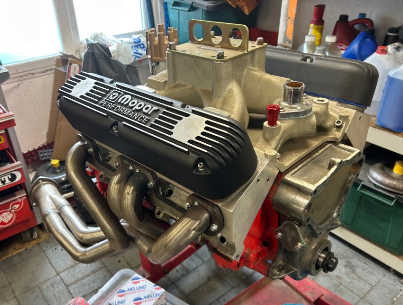

Finally I’m ready to get on with this, my next engine which I bought a couple of years ago. I’ve been collecting the extra parts I needed for it including the rare “wide” valve covers and the big tube tti race headers. This is another 360 based 408 stroker, it’s been converted to 4 bolt mains, has a gear drive, solid roller cam and Indy 360-1 heads and intake. It’s got the potential to run as fast as I’m ever likely to be able to afford and If I get things right it will still be street usable. It came with a dry sump oil system as it was going into a tube chassis car, I neither needed or wanted the added complication so a new wet pan was needed.
