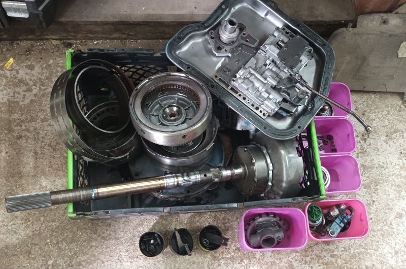

Getting ready for the strip down , all washed off.
I wish I knew who Molly was, this came in the car when I imported it, she must be in America , the car came from Arazona .when I removed it , I saw the writing on top of it 🙂

The numbers on the box point to it being a 1976 heavy-duty van/truck.
It dies have 4 pinion planetary's, so that's a result.

That's the easy bit done 😬
