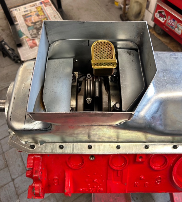

Re: Blue's Barracuda

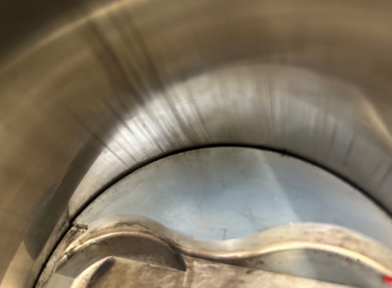

I now have the correct depth pick up so I’m back on with pan construction. I’ve clearly been hanging around with Hot rodders too long because I’ve suddenly moved the goalposts and sold the 408 rotating assembly and decided to stroke it out to 426…
With that in mind I’ve been stripping the block and measuring in preparation for getting it machined and found someone’s idea of a ready to go bore, scratched and no crosshatch at all. The block is already at 0.030 over and Today I’ve found out I can get 0.040 pistons so unfortunately its going to end up at 428 ci…
it's a good job you decided more is better or you wouldn't have found out about that bore until it was in the car and smoking.
neil.
neil.
I would have found it anyway. I never fit a bought engine without stripping it first and you always find something that needs addressing. It’s not just one bore they are all like it, who puts an engine together like that?
