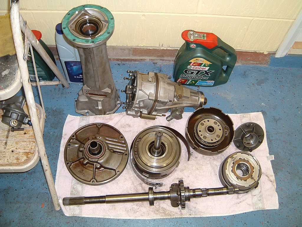

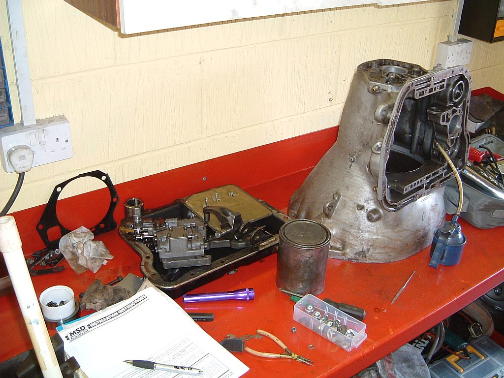

First time you rebuild a box you think it is going to be a nightmare. But actually they are quite easy to rebuild as long as you take your time. No specialist tools required although one or two home made tools can make it easier. An air compressor can help to test things as you go but I rebuilt mine a couple of times without one.
But then again, Dunc needs to pay for that new Bentley of his. :thumbright:
Below is what you find in a transmission. As you can see it brakes down into sections. Each section is re-built as a unit. It is just seals and clutch plates. This is a 727 but your box is almost the same. You don't have that funny tailshaft housing and overdrive unit either.
The guts plus overdrive unit.
727 case and valve body.

Dave wrote:First time you rebuild a box you think it is going to be a nightmare. But actually they are quite easy to rebuild as long as you take your time. No specialist tools required although one or two home made tools can make it easier. An air compressor can help to test things as you go but I rebuilt mine a couple of times without one.
