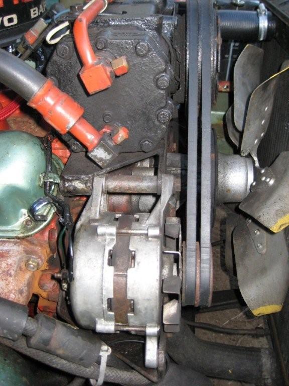

ALTERNATOR:
Do the US alternators mount up the same as mine?
see pics.
I believe this has 2 lugs on it so it can also be mounted on a 6, that is why you will see a unused threaded lug past the end of the adjusting arm.
Thanks

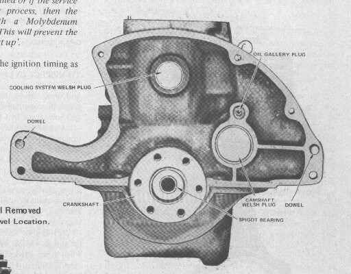

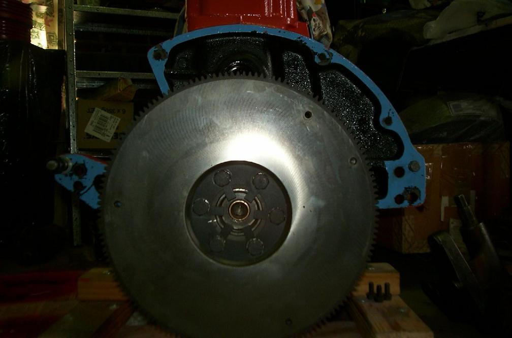

Posts: 9603
they made a hemi for 3 months or so that bolted to a 904
this was to cover a stirke at borgwarner....
they get called an S block hemi due to the S on the engine nunmber pad
all hemis have S cast into the block....thats not the correct S for identifying an S block hemi
dave
s block hemi
s block hemi
standard hemi
standard hemi

Loving their "welsh plugs" on that picture.
Surely they knew the correct term-welch plug :lol:
1965 Belvedere 2 426 Wedge.
VGVIP
Post by VGVIP »
Hi Steve.
I have always called them welsh plugs
:oops:
Posts: 9603
'Strine is a different language mate!
but yes that is a diagram from the factory service manual
sounds the same when ya say it
so its OK

Steve, teh best bet with the alternator is to take it off and go down to your nearest old school type breakers and match it up with something else with the same mounting pattern, you may need to change the pulley over though, but some 4 wheel drives etc use twin pulleys.
Giles
