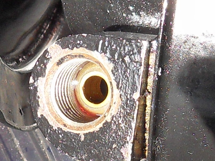

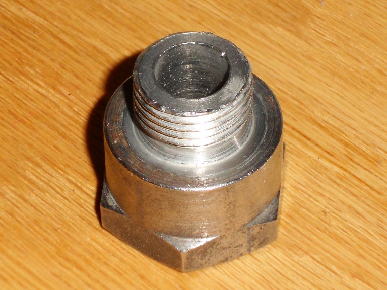

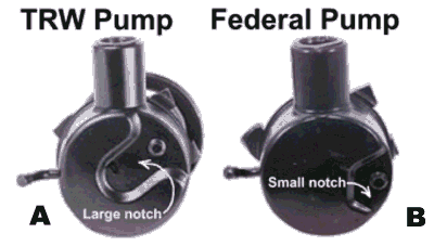

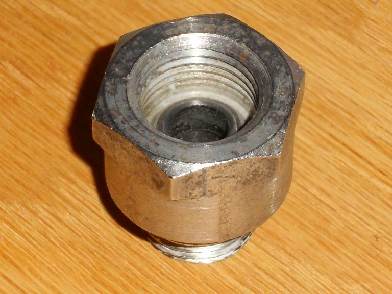

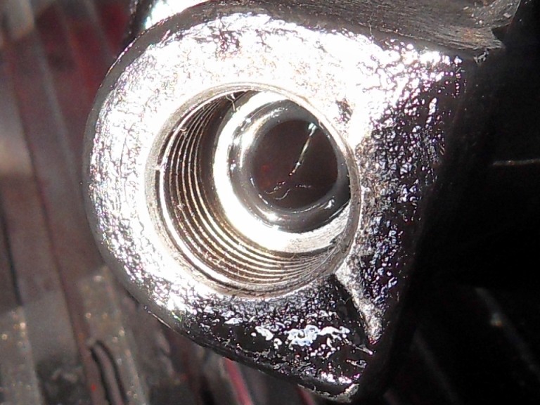

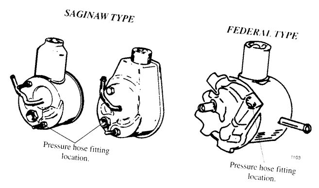

Posts: 7583
Hi Trev,
as promised, a couple of pics that will help you to not make the same mistake as me!
couple of pics of the different seats inside the pump outlet and couple of the adapter I used to change one to the other so I could use my new pump......lot of hassle that could have been solved by just buying/ sourcing the correct like for like replacement!
Cheers Steve
PS this only relates to the TRW pumps which appear very similar to the Thompson. Think the Saginaw has an oval filler neck but I may be wrong
FEDERAL TO TRW ADAPTER 1.JPG (196.76 KiB) Viewed 796 times
Pump outlet domed seat TRW.JPG (152.26 KiB) Viewed 796 times
pump outlet flat seat FEDERAL.JPG (150.38 KiB) Viewed 796 times
Pump types.gif (19.06 KiB) Viewed 796 times
Posts: 7583
:lol:
FEDERAL TO TRW ADAPTOR 2.JPG (192.42 KiB) Viewed 793 times

its in the camper so cant get a pic but it appears to be the saginaw one on the left in Daves pic, oval filler tube and round body. cheers for all the help guys.
