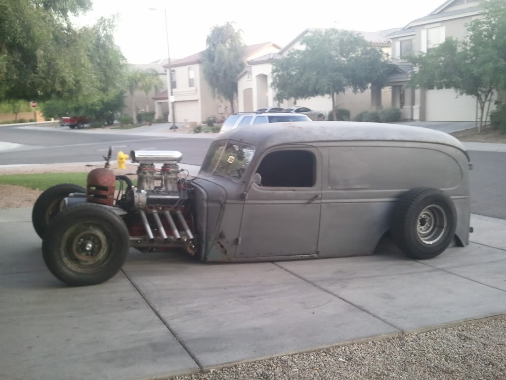

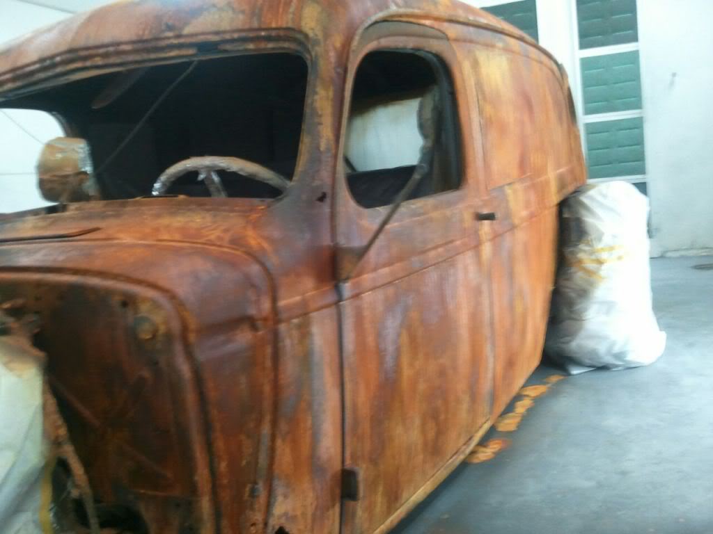

It is your choice Paul. You could get a good sealer on there, then get it down to Jem for the perfect faux rust look!
That would look soooooo sweet!
Jeff
Posts: 7972
Location: Ontario.
Post by Jeff »
from this......
Jeff
Posts: 7972
Location: Ontario.
Post by Jeff »
To this, in a week. And all the metal is protected underneath!
Jeff
Posts: 7972
Location: Ontario.
Post by Jeff »
How cool is that! :thumbright:
