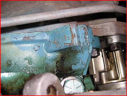

If I remember correctly the Aussie 318 blocks had the engine number stamped in a different place to the US ones. US at the front of the engine block under the left hand head, vertical surface.
Aussie blocks had nothing stamped here, look on the horizontal surface at the back of the block above the starter motor (or where it fits if not bolted to a transmission). Rear left hand side on the block.
Can check mine or see if I have any pictures here on work laptop.
VGVIP
Post by VGVIP »
This is an Aussie 340, as far as I know the Aussie V8s had their numbers stamped here.... at least from the VG onwards (1970).
