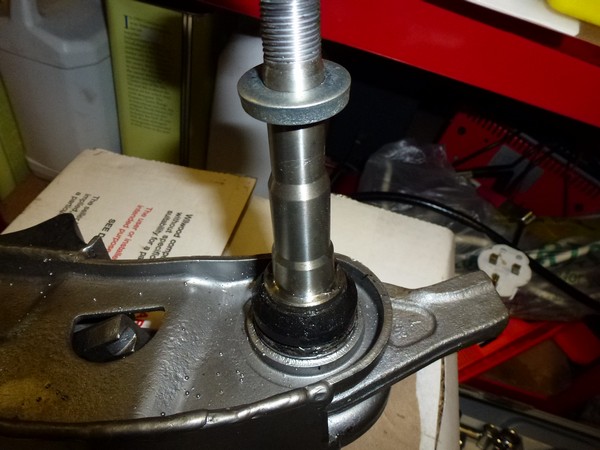

The shell get pressed into the LCA as normal, the 'inner' bush is a poly jobbie which is shaped like a mushroom or muffin-top. See pic for detail. This hasn't looked right to me from the off....
The problem comes that because of this (I think) the LCA does not sit far enough forward on the pivot. The net result is that the torsion bars don't go far enough forward either, and the struts at the front (the diagonals that bolt onto the LCA) cant bolt up either, they don't go far enough forward.
The problem can be clearly seen on the other LCA (still off the car) - the pivot doesn't go all the way into the bush - it cant, because of the muffin top.
I realize that is a really bad description. Basically "Does that bush look right to you? I think it needs the mushroom cutting off". This would allow the whole LCA (torsion bars, strut, the lot) to sit a 1cm forward and thus align properly. It really isn't much - less than a cm - but its a critical cm without which the assembly wont work.

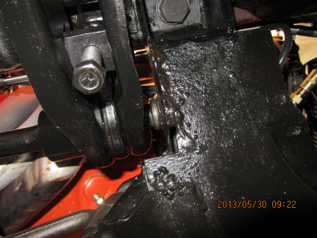

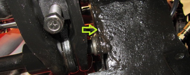

A quick pic under your car would be good to see where the LCA meets the pivot. Its the one angle I don't have :oops:

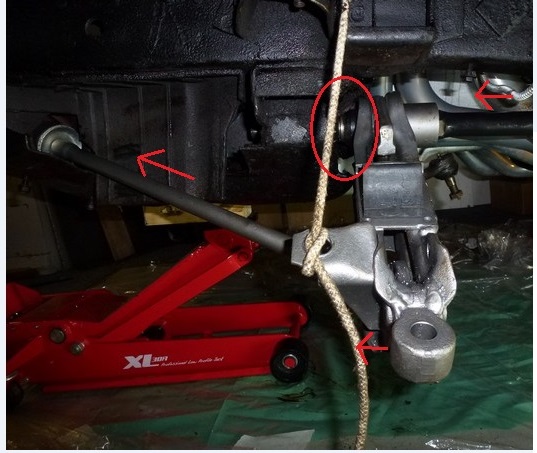

Here is the whole thing. red-ring shows 'muffin top' and the arrows show how the geometry needs to move forward.

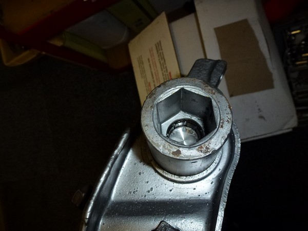

Viewed from the other side you can see the pivot aint in all the way.

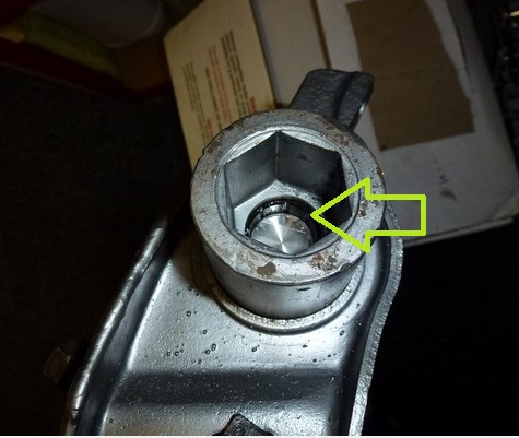

This clearly shows the 'muffin top' which prevents the shaft going far enough i.

Looks wrong to me - does not look seated suffiently deep.
I always use rubber LCA bushes as they are positively located and this issue does not arise.
I guess - If the bush is the correct one for your application - the issue is understanding why it sits so proud..........

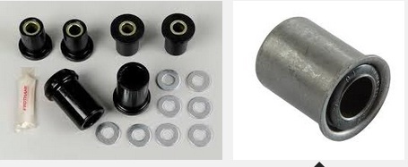

Google search on lower control arm bushes. First 2 pics show the problem.
The one on the left is what I have (and seemingly all poly bushes look like this). The one on the right is a stock LCA bush from yearone.
Clearly they are not going to locate the LCA in the same place - The stock item will allow it to sit closer to the k-frame.
I have a set of stock bushes. If the hotchkis pivots fit them then I think I might press the poly out and start over. I cant help but feel I am missing something though ? They cant be wrong - why would they all be made like that ??
Left is poly, right standard.

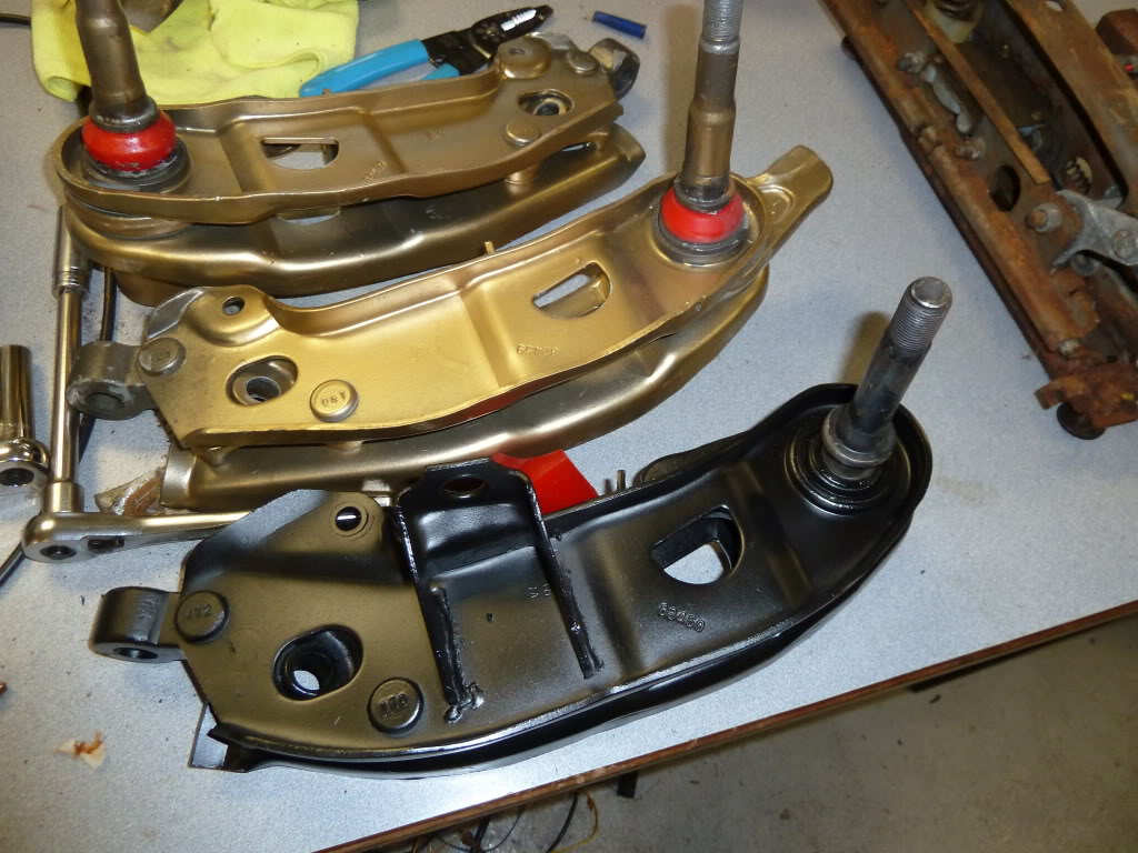

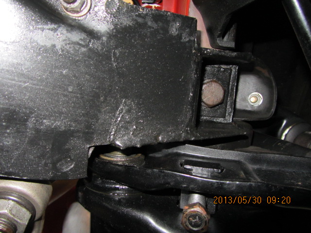

Here are the pics, don't help a lot, I'm afraid....
Bee LCA bushes 005.JPG (137.17 KiB) Viewed 1098 times
Bee LCA bushes 001.JPG (128.88 KiB) Viewed 1098 times
Posts: 4262
Actually Pete, thats pretty helpful. there *is* a gap between bush and pivot, which implies it doesnt need to 'butt right up'. Which in turn means that if the poly seats right, the muffin-top should just sit on that gap. My muffin-top must be too proud.
Not sure what stops your LCAs moving forward though ? Must be the shaft butts right up to the torsion bar inside the LCA. (which would seem logical) Pic (A)
Either way - what you have shown me gives a good lead. I do appreciate it.
Pic (B) shows the root of my issue I believe. That shaft should be flush to that torsion bar mount. Need to discover why it aint. Much measuring and compare first.
