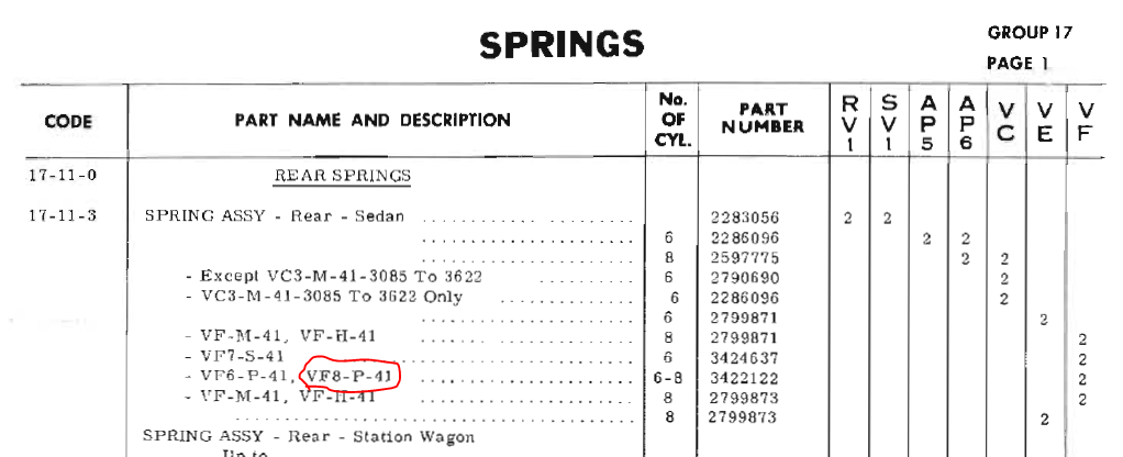

Parts book. Does not include VG and there was little to no difference between VF & VG VIP... and I know my code is P-41 looks like they were a different spring to the other VF. I guess this is only to cater for different body types and loads so will be spring rates and number of leaves rather than dimensions.

They all take a 55" x 2.5" spring.
At 3235lb VG VIP is 120lb heavier than the VG Hardtop. I expect the VG hardtop will be almost identical to the late 60's Dart hardtop in weight.
