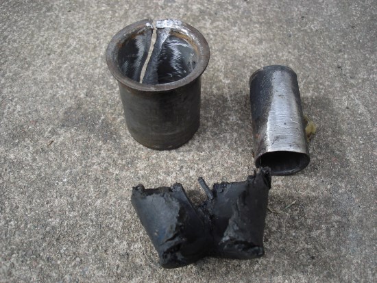

Wolfman
Posts: 608
Location: Walton -on-Thames
Post by Wolfman »
Mick70RR wrote:I did mine without a tool. Take the lower arm off together with the torsion bar and just knock the arm off.
Yep your idea worked a treat, I think they needed doing me thinks :shock:
