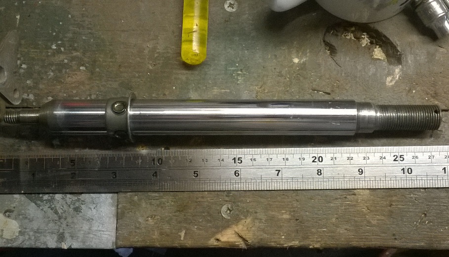

I've stripped them down now and both rods need repair.
I spoke to Philpotts who seem to be the bikers favourite. There's another place called Dynasurf within driving distance, but I've no idea if they're any good.They all charge about £60 each rod which is ok. Philpotts have a turnaround of 'a few weeks' :( I couldn't get hold of Dynasurf, Friday afternoon innit... :roll:
The other issue is that there's a flange welded onto the rod. Hopefully they can work around that.
Shock rod.jpg (231.22 KiB) Viewed 780 times

They're not corroded Pete, they're damaged, what looks like pipe grip or vice marks.
I don't think stainless can be made smooth enough, the seals would rapidly wear. I think they have to be hardened steel with a hard chrome finish.
