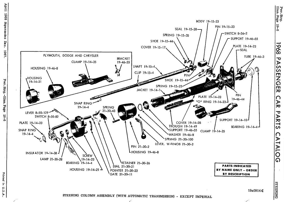

There should be no in and out movement, there's a circlip either side of the bearing to stop that. If someone has removed the steering wheel by whacking the centre of the column, that usually unseats one or other circlip.
<a href="http://s73.photobucket.com/user/autofet ... x.jpg.html" target="_blank"><img src="http://i73.photobucket.com/albums/i205/ ... 5q1mhx.jpg" border="0" alt=" photo 397147B6-5931-4029-AAF5-180F3B0A7654_zpsez5q1mhx.jpg"></a>

Thanks for the diagram, the bottom circlip was missing. That has solved the back and forward movement. but there is a bit of side to side on the shaft. I don't have the support 14-96-8 on mine. is that the problem?

14-96-8

Sorry, im an idiot, its 19-46-55 :oops:
1969 Dodge Charger
1972 Chrysler Hardtop
That's looks to be the problem :thumbright:

My column is made up from parts, that looks to be the only but missing.
Does anyone have a spare?

is part 19-46-8 housing, held in place with any screws pins etc. As when the columns all assembled with the clip either side of the top bearing the housing is a bit loose. is this normal?
