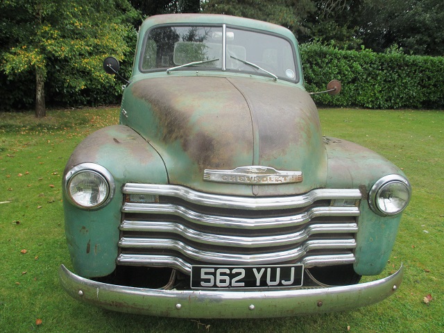

Or rub down lightly with fine wet n dry and clear laquer it like I did with my old truck.
chevy truck.jpg (161.14 KiB) Viewed 975 times
