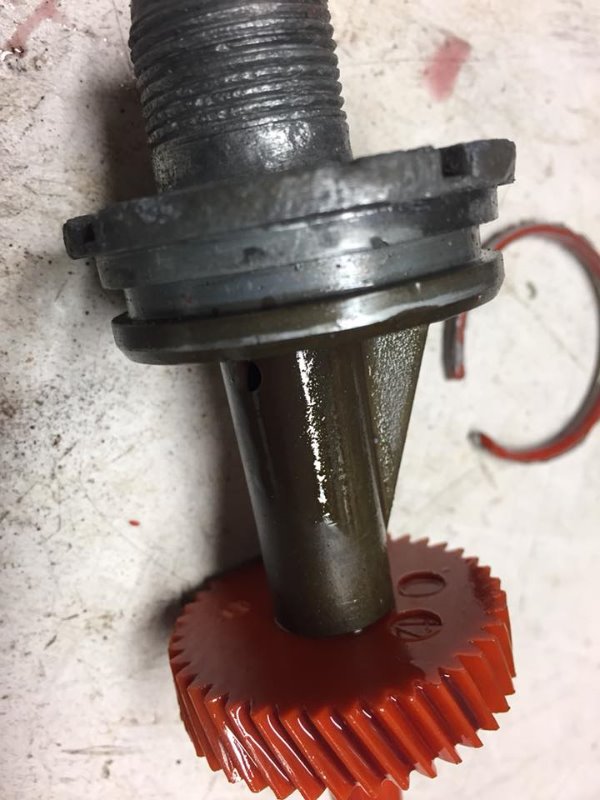

Well got the sump off, the filter did look pretty grim and on the plus side, found the culprit to leaky box
Just got to find a new seal

that should be an o ring, looks like a split square section seal fitted ???? or poor pic,,
