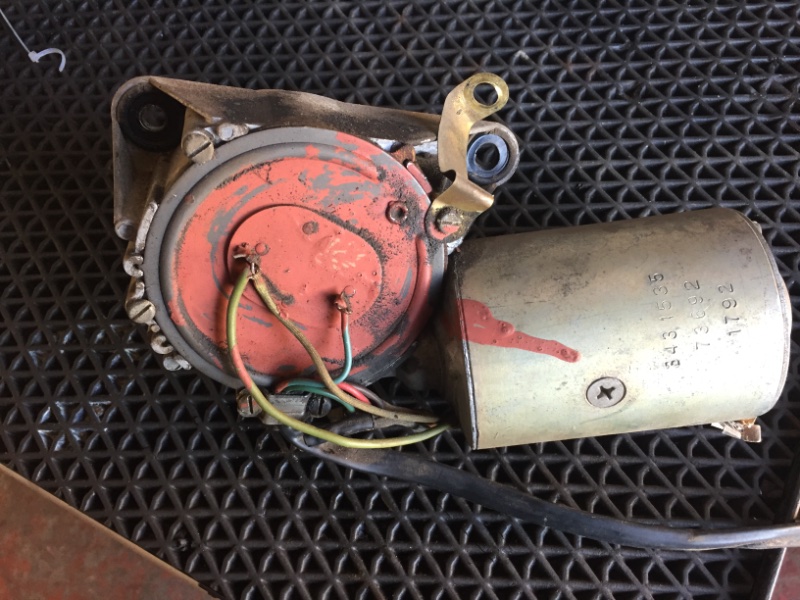

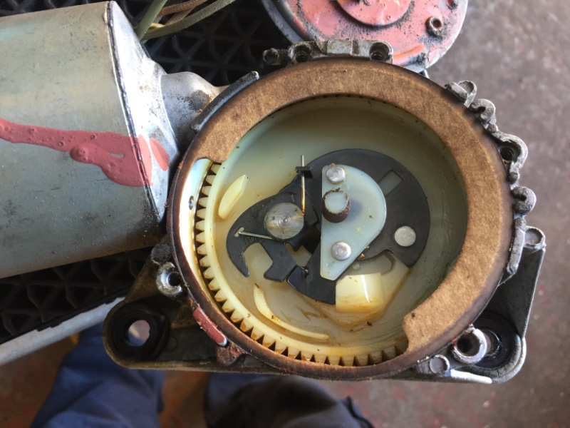

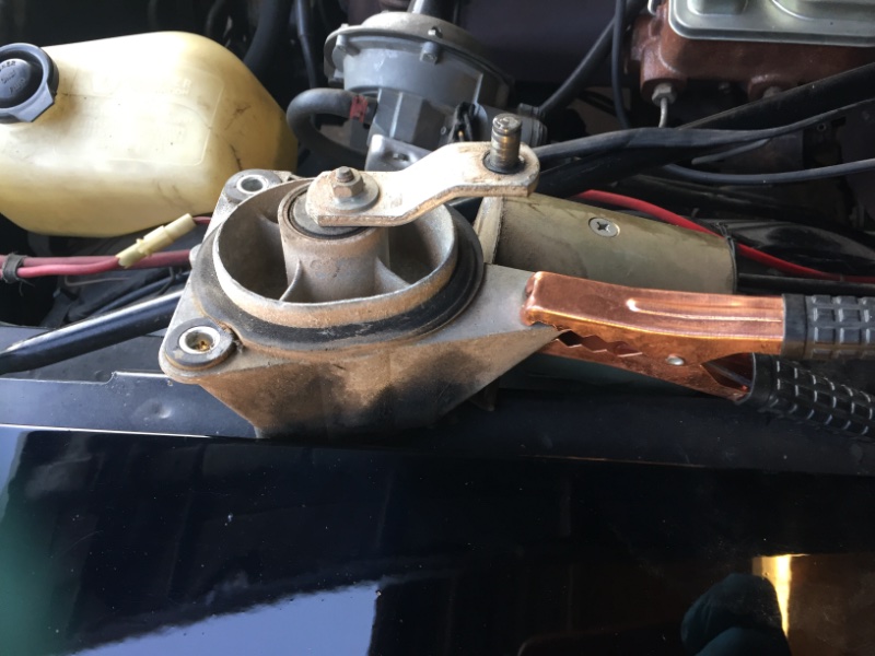

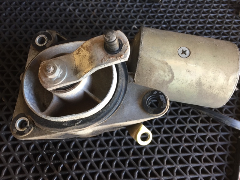

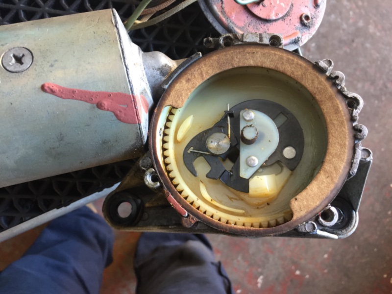

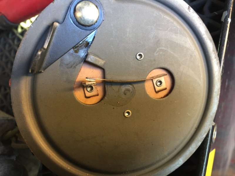

Re: wiper park on my 72 new yorker
Tried what dave said about the dash switch but gave up as the switch is a total bitch to get at on a 72 c body
Obviously checked the bulkhead connectors which looked surprising good
So decided to remove wiper motor, I removed the clip to disconnect the wiper mech rather than the much easier nut as previous experience had taught me if I removed the nut instead the wipers would never be in the same position again
Removed motor and took to bits and found a switch like a set of points was discoloured so cleaned up and freed up the pivot mech
Put all back together and tested, before fitting to the car
Bingo works perfectly again
Well happy
Well happy
Photos
- 414E5472-8B97-4433-AD9F-9EF51AD2B36A.jpeg (195.58 KiB) Viewed 2097 times
- A9EB955E-358F-4C2A-A91E-9B9EFE5541E1.jpeg (187.99 KiB) Viewed 2097 times
- 7CD9568F-A4D3-4A27-986D-9836B108B642.jpeg (165.81 KiB) Viewed 2097 times
- 6FE57A66-B8E4-4412-96D8-D16EE3B55089.jpeg (163.54 KiB) Viewed 2097 times
- B3FFDC4A-EBB3-4AE4-A3F2-48496F2E0890.jpeg (140.15 KiB) Viewed 2097 times
- 963709F2-8C1C-4E64-84F2-85365661E0E7.jpeg (133.59 KiB) Viewed 2097 times

the motor and the body of the wiper switch should be bolted to a bit of steel bar.
keep your hands away from the linkages, they will take off your thumbnail like a knife through butter
and the bar should be connected to the negative of the battery
you will not get any sense out of it unless the motor and the strip contact that earths to the dash around the switch mount share the negative/earth
dave
dave
