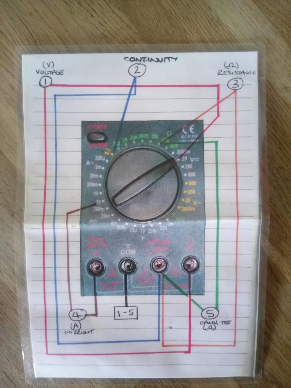

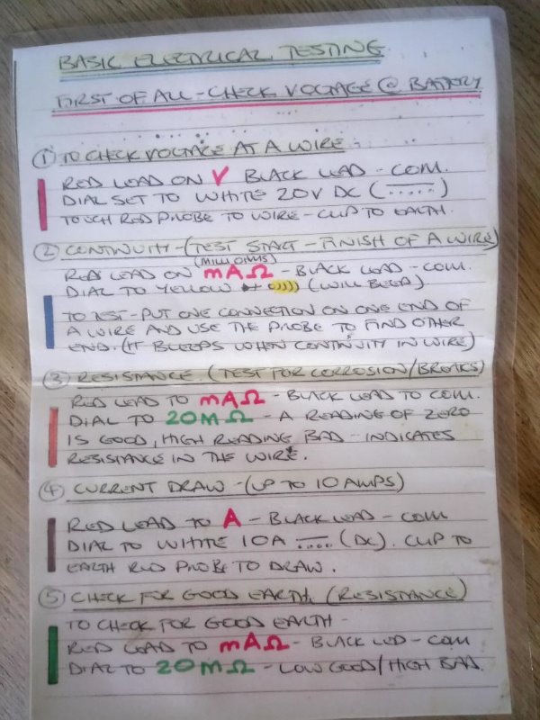

Good work Dave....you persevered and got there.
I was terrified of electrics when I got my car but, with yours and others help, I now enjoy working stuff out and learning. I have one of those probes and its great for quickly testing that the unit drawing current is working (indicators etc). Well worth having in the kit. I also have a remote starter that is a God send. Another good addition is a 6ft length of wire with a big crocodile clip on one end and a small one on the other end. Great for a quick hotwire to fault find and sometimes get you started and going again!
I have just been helping my pal fix up his 53 Packard. It had a sluggish starter motor and was a nightmare to get going. I made up really heavy leads to the starter and earths from battery to engine, engine to body and rear of engine to bulkhead. Starts perfectly now.
My Uncle is a very clever design engineer.... he has many words of wisdom and can fix anything (except my dress sense). His words stick in my mind....

Don't mean to hijack the thread Dave.
When I realised I didn't have a clue about auto electrics or how to use a multimeter, I sat down with a friend who does and I took notes. Made this up, may help others...
Cheers Steve

that continuity tester is the key to happy fault diagnosis in many cases.
