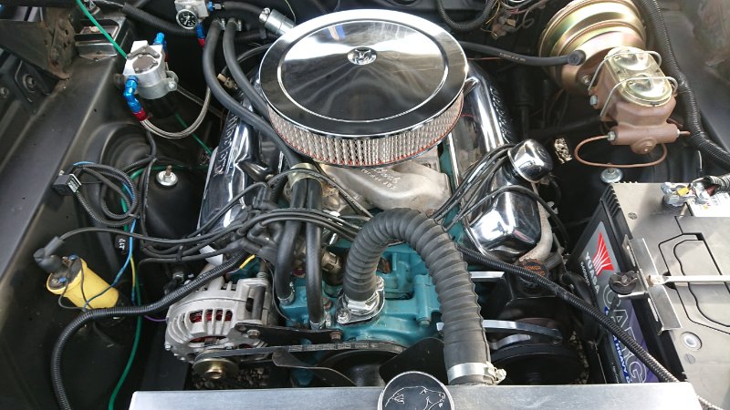

Got a wierd problem - 383 is running fine but on 2 occasions motor has lost fire on hard deceleration / engine braking and wouldn't restart.
(Both times in traffic so pretty embarasssing)
Thought initially it was a dirty fuel problem as I'd just cleaned carb, but on both occasions great fuel pressure and cranking fine but wouldn't fire.
Managed to refire after leaving car sitting for about half an hour and fiddling with coil connections and jiggling coil.
So now thinking I've got a bad coil - Ancient Accel Superstock coil mounted on inner fender (see pic).
So 2 questions:
1) Am I right in thinking coil problem, or should I be looking elsewhere?
2) If it is the coil, what's a good replacement? Been looking at MSD Blaster 2 coil as a relacement, but says I need a ballast resistor to work with my points ignition.
Will probably be converting to electronic ignition at some point, but looking for a short term fix to get me back up and running.
Any thoughts / advice welcomed.

The first thing I would check are the LT connections on the coil. Check for a tight connection and check if the spade terminals are green with corrosion. Get it running and then try gently wiggling the connections to see if you can make it stumble or cutout.

Checked all connections and wiring, and all clean and good, so looking to get a replacement coil.
Still a bit baffled why I only seem to lose fire when I come off the throttle.
Car has always taken a lot of cranking to start (esp when cold) and doesn't like to idle, but had always put that down to the big cam.
Also, due to my ignorance still a bit confused about the ballast resistor - checked all my wiring and can't find any additional components in the coil circuit, so do I need one with a replacement coil?

LurkinLimey wrote: Thu Jan 03, 19 10:35 pm Also, due to my ignorance still a bit confused about the ballast resistor - checked all my wiring and can't find any additional components in the coil circuit, so do I need one with a replacement coil?
Thanks again,
Limey
Stock mopar stuff runs 8v and only supplies 12v at startup.
So on crank you get the full 12v and once running it feeds through the ballast and knocks down to 8v.
Depends on the ignition module you have.
If its points; ballast. If its mopar/orange-box - ballast. If its aftermarket it might be 12v and NO ballast (hei module or MSD all in one).
It looks like a white block and mounted on the bulkhead. There will also likely be a voltage regulator next to it.
The coil may offer a clue - does it have any labels on it ?
There are LOADS of ignition diagrams kicking about - I spent ages going round this loop. You'll chase it out. (but answer blues question on carb first!)

It's an Accell super stock coil, they use the stock ballast I believe. To further clarify, it's the coil that dictates if a ballast is needed or not. Some coils happily run at a constant 12V, others will fry if subjected to more than a constant 7-8V, that's the only reason the ballast resister is there.
