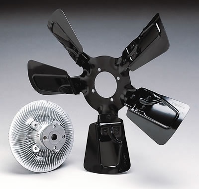

The correct type will look like this...
It's normally only A body applications that are really tight and require the shortest hub. About 3/4" from the rad core to the nearest part of the hub is as close as you want to go. I know Dusty on here has a new one for sale that might suit you.

#offtopic - but is that a wonky photo or a wonky fan ? I cant quite align my head to it
Posts: 9564
Re: Swapping to Thermal viscous fan from standard
no they are like that
dunno why but they are
presume it creates some pulsing or turbulence that is considered useful
or it will reduce noise. I bet the pulses caused by the offset blades cancel out the pulses caused by the normal blades making it quieter
somefink like that

Yes the fan blades used to be assimetrical like that, the ones they supply now have a regular pattern.
