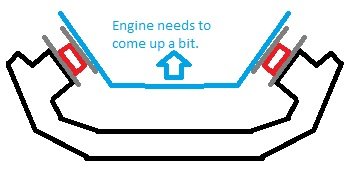

As the title suggests... any suggestions ?
I've always suspected some of my clearance issues are caused by engine sitting slightly in the wrong place.
I had issues with headers fouling idler arm on steering bar; and now its out I can see where the other side has been touching the torsion bar at times. Basically the whole unit is sitting too low - fair bit too I think.
Previously I had to make up some shims and fit them between the mount and the pad - that got me past the idler issue - but it aint enough.
Mounts I have are 'stock' 440source. I either need slightly longer ones or bigger pads. Does anyone know if there are options on this stuff ? Or is 'stock' it and I have to get something fabricated to bring it up a bit ?
Enjoy the AMAZING artwork illustrating my requirement. :D
Highly technical blueprint of requirement

You could maybe oval the holes in the K- member upwards and shim under the mounts a little . Wouldn't get you that much height though.
Or It would be fairly straightforwards for a metalworker to fabricate taller mount brackets.
If you raise the front of the engine too far you'll affect the driveline angle, and your fan may hit the shroud if using stock items.

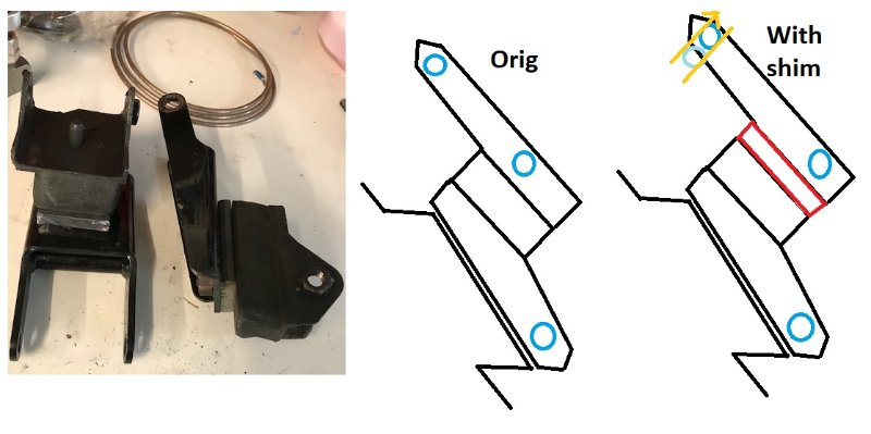

(got the old ones out. They dont look squashed etc - but not hugely deep either. will post).

My mounts are stock, not poly. I inserted a 5mm aly shim on one side last time out to clear the idler - but this time round I want to seat it right. Trouble is, shim too far and the mounts become too close together. Ideally I just want 'longer' upper part of the mount - something that maintains the x axis but extends the y axis. Worst case I might have to mick up a template and get something made.
Will have a ponder...
Posts: 4230
Re: Taller Engine mounts - 440 ?
OK; we'll see if this is doable. 10mm shim inserted.
The obvious problem will be that as well as raising things a little it also makes things closer.
I am hoping there will be enough wiggle to make this fit. We'll see.
In an ideal world I need to actually make a slightly longer 'arm' (top part of the mount) so that it just sits higher, but seeing if this works first...
