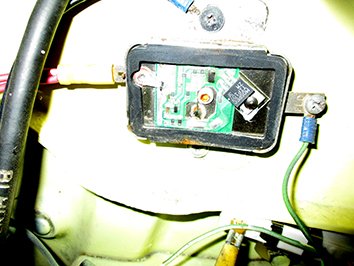

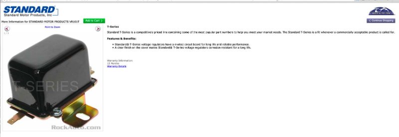

thanks guys, was the ECM, i've changed the coil too. Just wanted to check the correct voltage regulator to order. Mine has the circuit board. On another note, has anyone uded Dynamat or silimar? i find with the new stainless exhaust the noise and heat inside the cabin are uncomfortable.

Posts: 4229
Re: electronic control module/orange box
If its electronic then it should be fine. In my case the old reg had like windings inside it, the new one was electronic. Orange boxes like electronic regs - so if thats what yours had I'd say you're good.
Posts: 1135
Cheers Morgan, that's what i thought.
