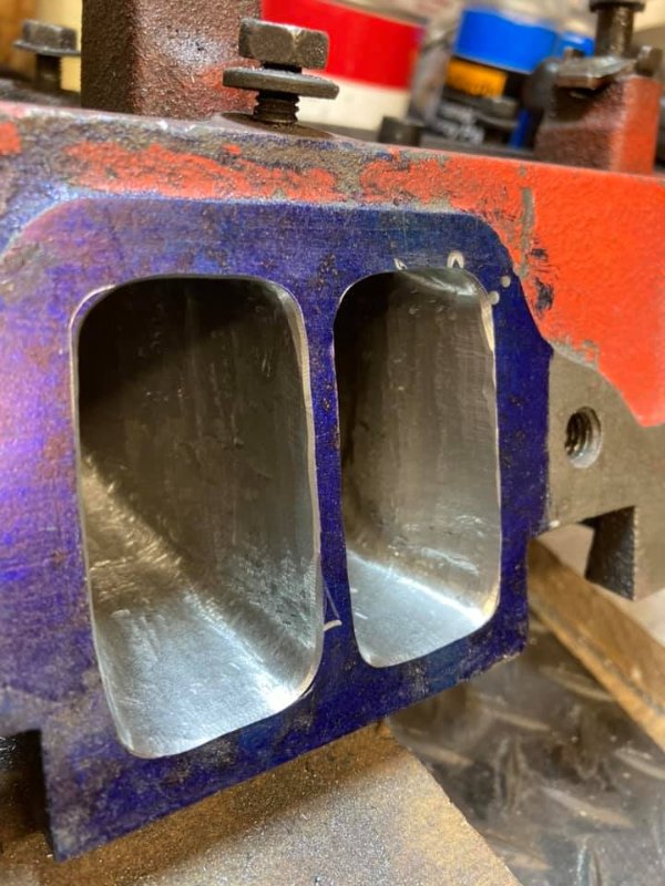

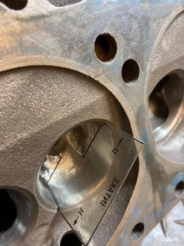

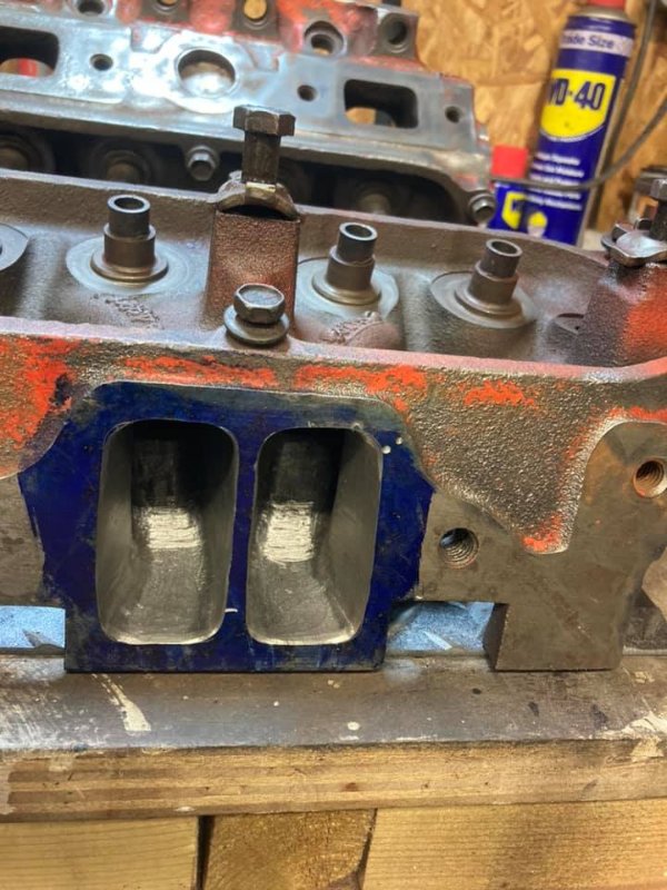

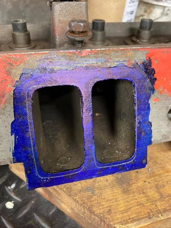

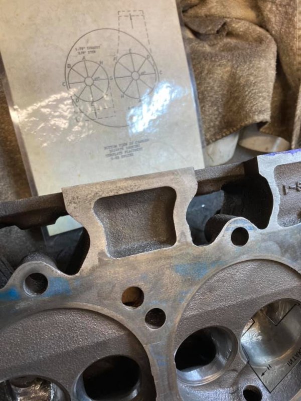

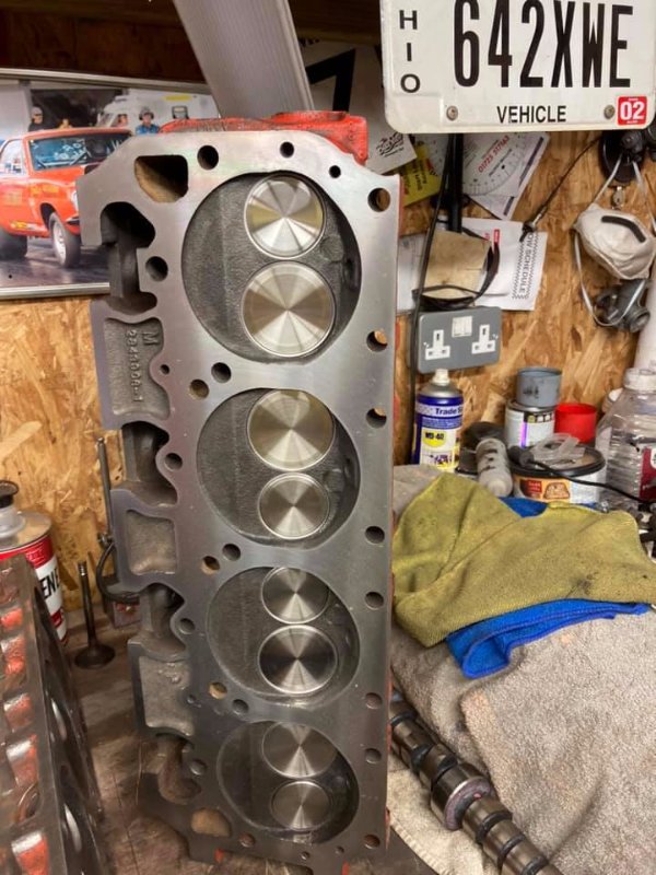

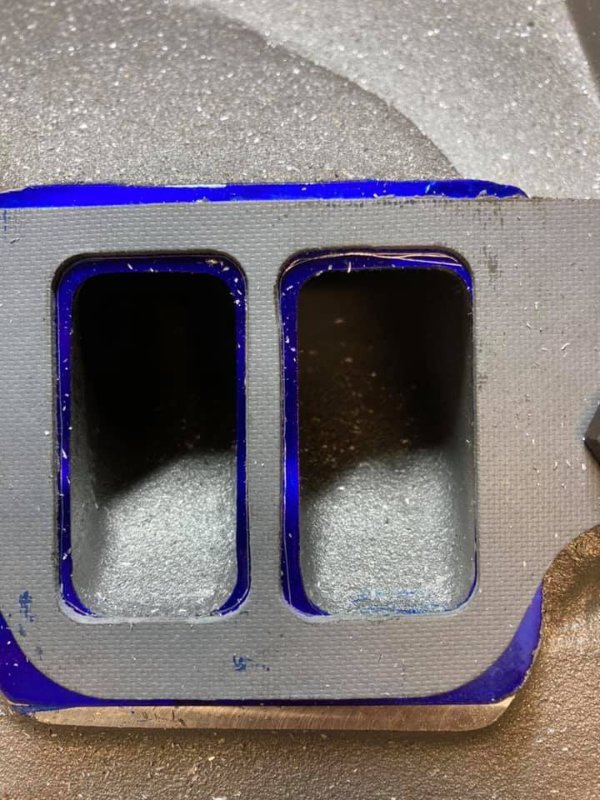

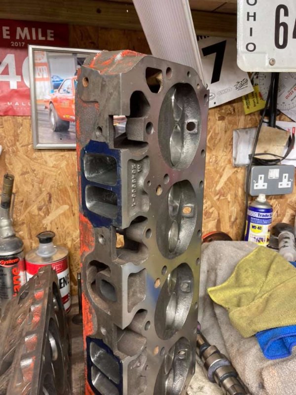

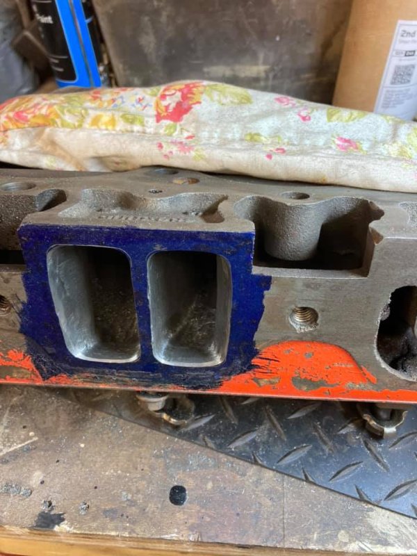

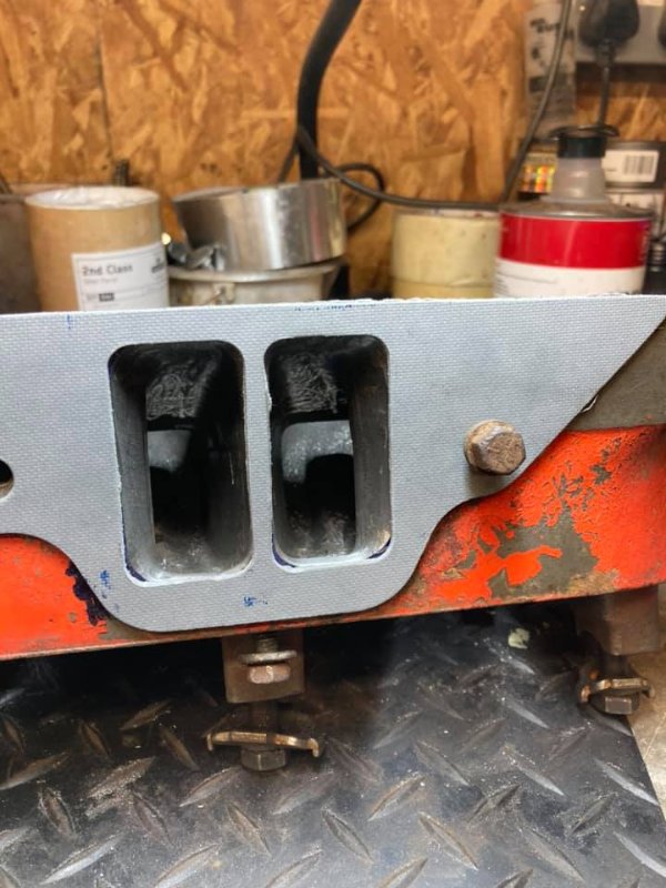

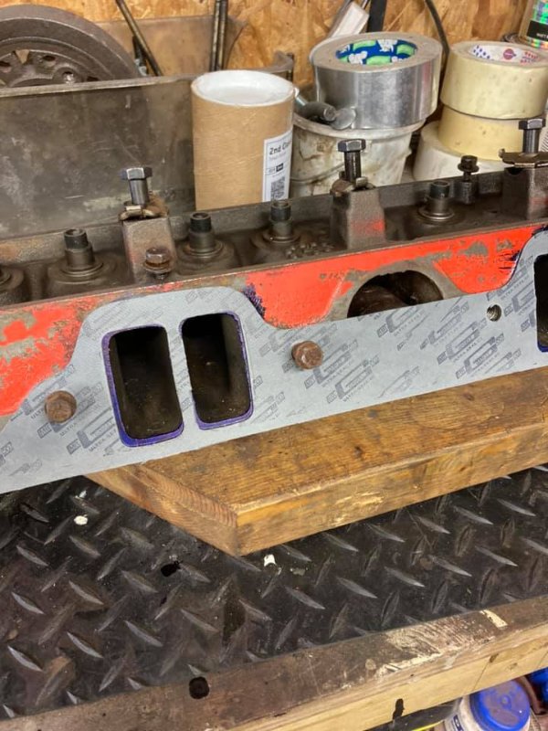

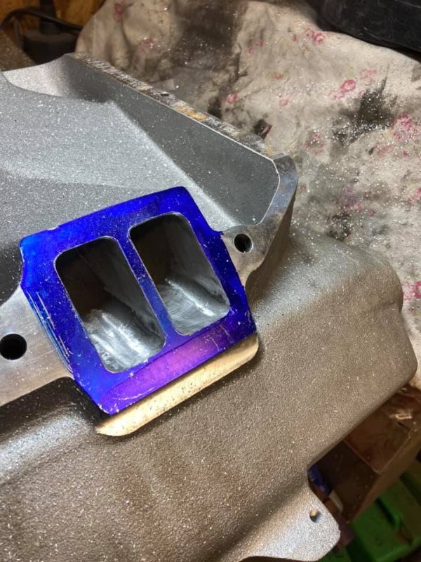

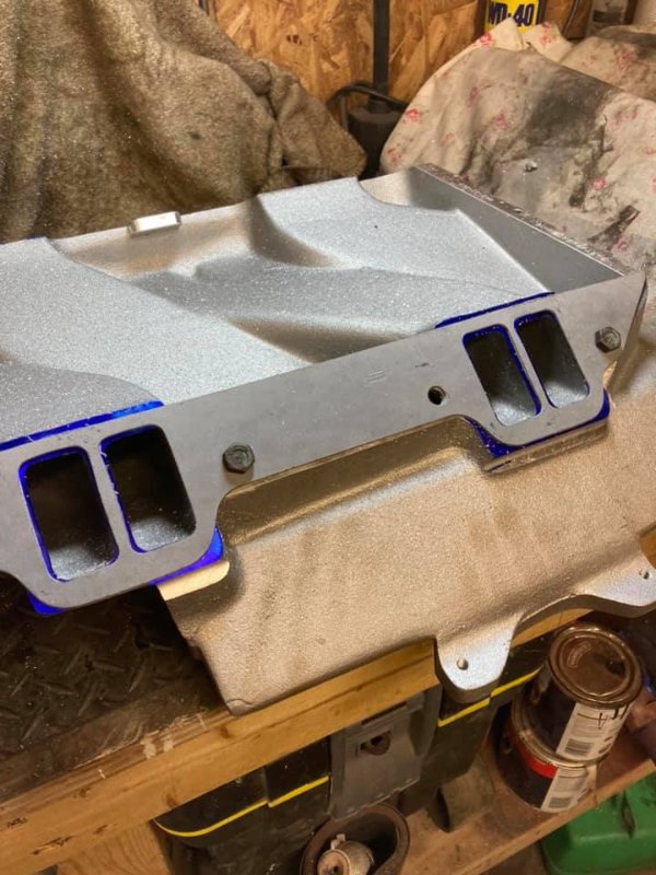

few hours work and they are ready for the machine shop .....thanks to Blue for the porting templates ..Will they work ???who knows .....i am going to try and measure the inlet runners for the volume to see if they are all even .....new valves coming this week then of for a valve job ...pictures in no particular order

Yes they will work, you have taken out the restriction under the valve basically.

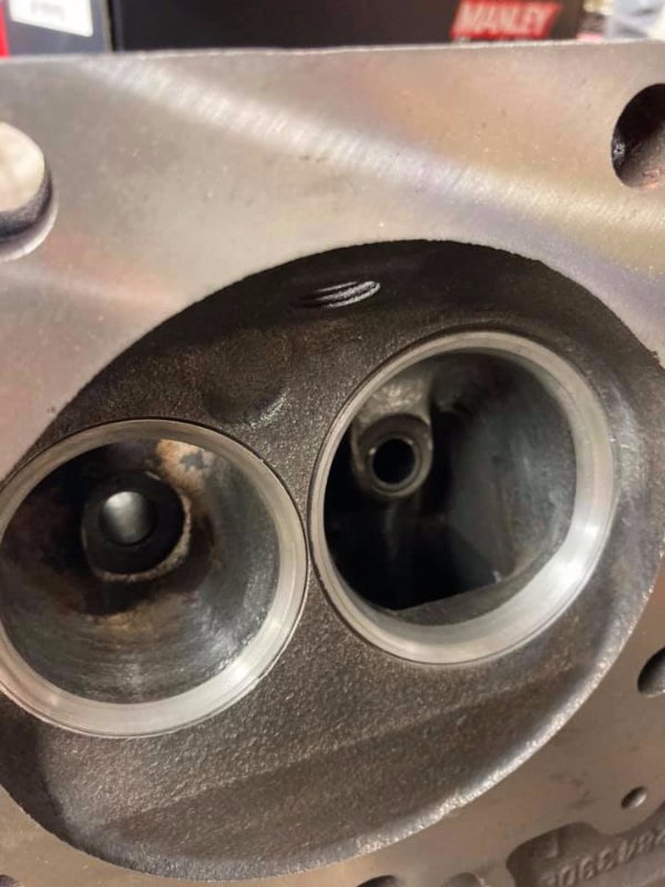

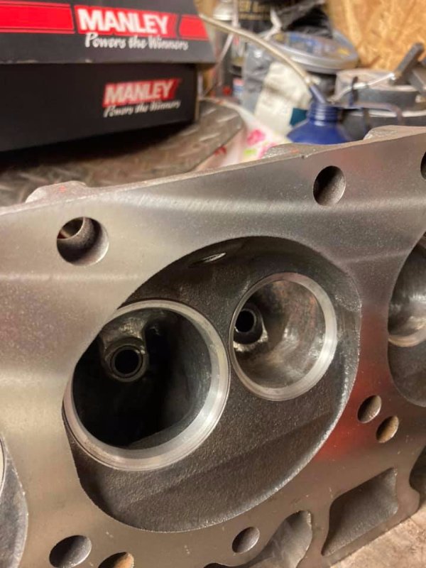

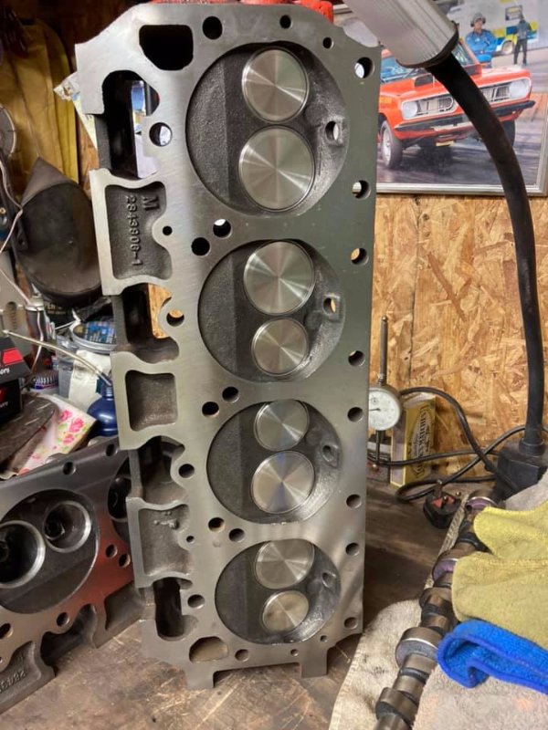

Got my heads back today from AMS ,valve seats all done ,slight clean up on the face ,porting finished up a bit better than my finish ...All said and done not as expensive as i thought and well pleased with the result ....will they work ???

I’d block the heat riser as well if I was me…

Blue wrote: Tue Jun 29, 21 5:57 pm I’d block the heat riser as well if I was me…
Having never personally blocked off a Heat riser, although I understand the benefits, how do they block them off ?
Do they fill with an epoxy or something else ?
Posts: 14434
Re: Porting Heads
Epoxy if you’re posh or melt an old piston down and pour that in if not….

Is that harder valve seat inserts installed there?
Is that best policy with no lead, even on US engines where they went lead free alot earlier than Europe?
I assumed the seats were hardened as standard or is that only 72 on?
Posts: 14434
Re: Porting Heads
Valve seat recession with unleaded fuel hasn't proved to be a problem with the limited mileage we do in these old cars Matt.
