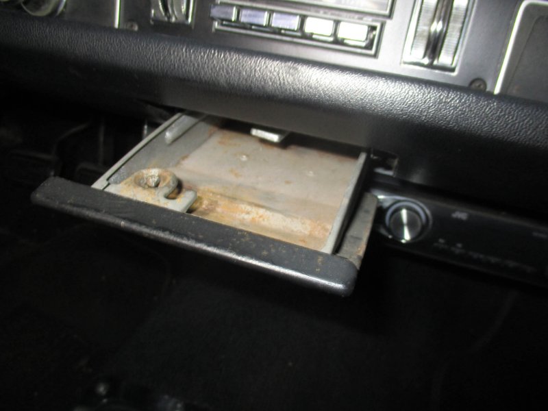

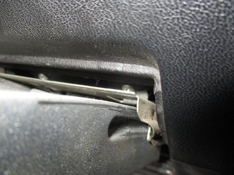

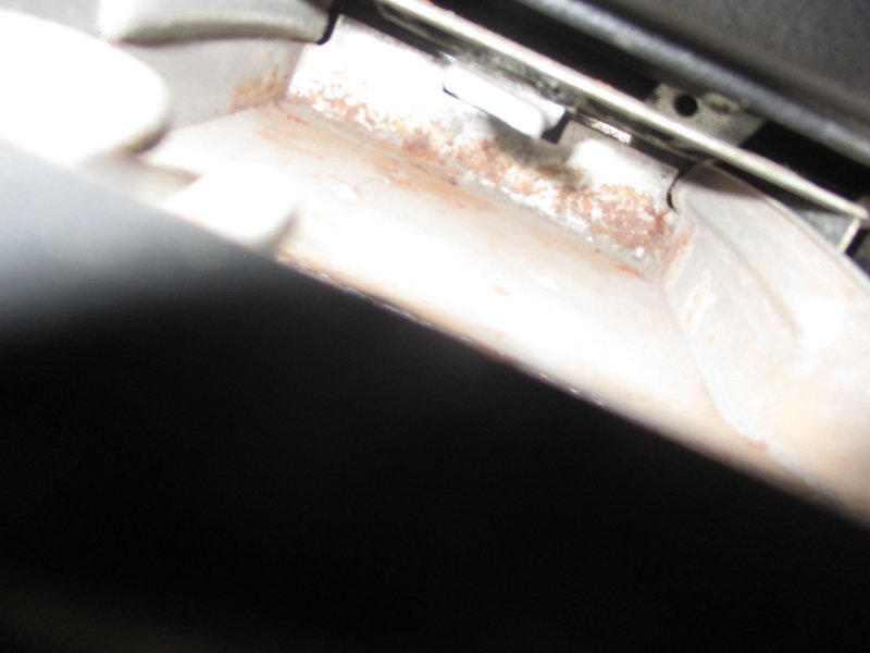

Posts: 1194
Re: I'm stupid.......A body Ash Tray
Billybob, the flat unit the ash tray slides into appears to me to hook over the lip at the back. (68 Dart).

Thank You now done with brute force and more stupidity !!
