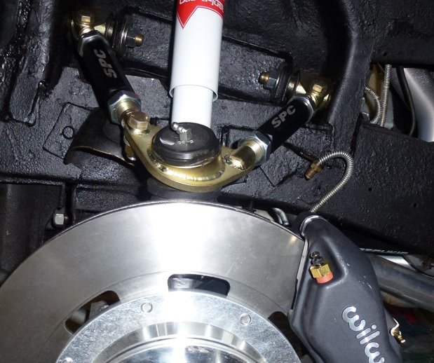

Yeah - I am running those. They went in clean, and Roger at Monkfish set the car up and recorded (his words) the best alignment he's seen on a Charger. Certainly improved things. Recommended.Matt74 wrote: Sun Nov 07, 21 12:39 pm It looks like Blue may be able to save the day but for future reference does anyone have any experience with these?
https://www.classicindustries.com/product/sp94450.html
They look well made and sturdy enough, fully adjustable and reasonably priced when compared to Hotchkiss.
- SPC.jpg (71.35 KiB) Viewed 11793 times

That's good to know Morgan, thanks.morgan wrote: Sat Nov 13, 21 10:42 amYeah - I am running those. They went in clean, and Roger at Monkfish set the car up and recorded (his words) the best alignment he's seen on a Charger. Certainly improved things. Recommended.Matt74 wrote: Sun Nov 07, 21 12:39 pm It looks like Blue may be able to save the day but for future reference does anyone have any experience with these?
I'll order some after Christmas!
