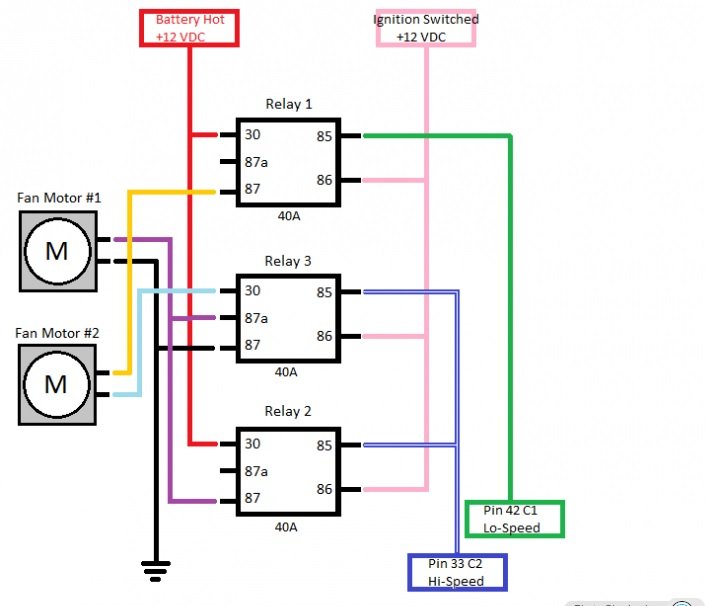

Just to add I have two 7.5in spall fans on the outside of the radiator hooked up to a high low speed switch.
fan wiring.jpg (46.59 KiB) Viewed 2662 times
