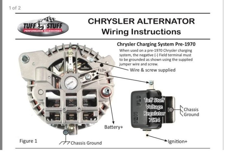

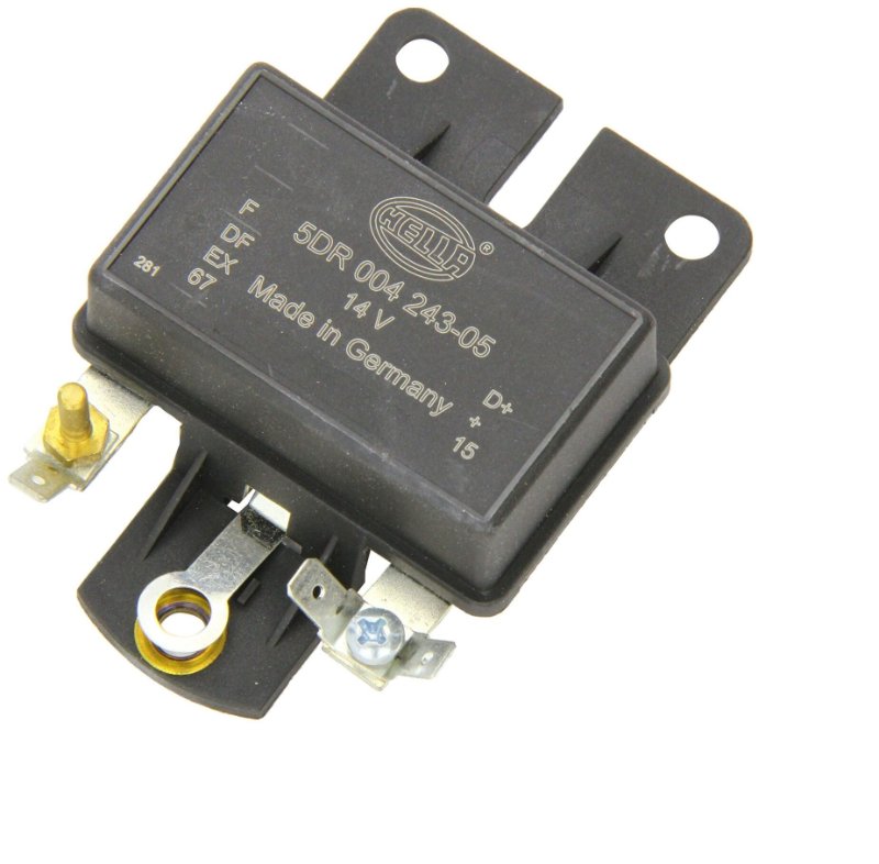

mopar_mark wrote: Thu Jun 15, 23 12:04 am Are you sure it has not got a built in regulator, most of single wire alternators I have used have had built in regulator. That said, I’m no expert in electrics.
It’s a one wire alternator set up, as indicated in the picture. I use a Hella voltage regulator again pictured all was good last year.
Since asking my question here I have taken all the internals from last year’s alternator and put them inside the nice shiny new chrome alternator.

OH ok
not a 1 wire alternator then...
it has 1 to the stud and 1 to the field
that is mostly like a standard setup from a 60s car
i.e the regulator puts out 0-5 volts depending on how flat your battery is
and it powers the field to produce the right voltage from the alternator to change the battery
what you actually have is a late 2 field wire alternator modified to work like an earlier single field wire alternator

OK so if you have 15 volts at the battery when alternator is full on
either
you have a poor earth for the regulator
you have a poor earth for the alternator
you have a poor earth for the unused field terminal
OR
the tollerances of alternator and regulator stack up in a really akward way which is over chargeing your battery and it will boil.
Or there is a fault with one or the other.
really needs to be less than about 14.6
battery will gas at 14.6 and 14.8 is too much
preume you have the output from the alternater connected to battery +
or have you done what chrylser did?
either way with running at say 1500 rpm
go looking for a poor earth connection volt meter set to DC volts or milivolts
start with regulator case to body and body to battery negative
other option is to bolt regulator mounting to the battery negative for a test and see where voltage at battery ends up at when you switch on fan and full beam.
if it centres around 14.5 it was an earthing problem with the regulator

But as soon as I put the supply through the regulator nothing. I have also bought a new regulator to see it that was the problem, still not charging
Posts: 9617
Re: Alternator wows
ok if you put 12 volts to the field terminal you will get big voltage out of your alternator...
normally regulator just varies between 0-5 volts
if when you plug in the regulator you get zero out of the alternator? is that becasue you battery is at max charge?
try again with the heater fan and headlights etc on.
i.e some load to get it to do something...
